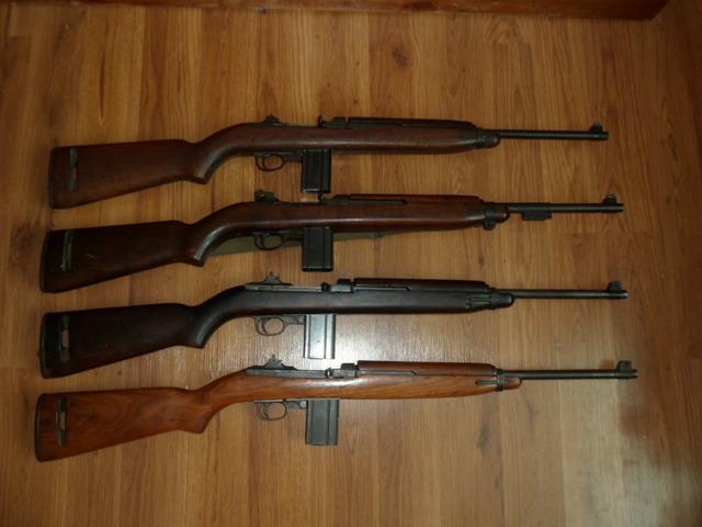

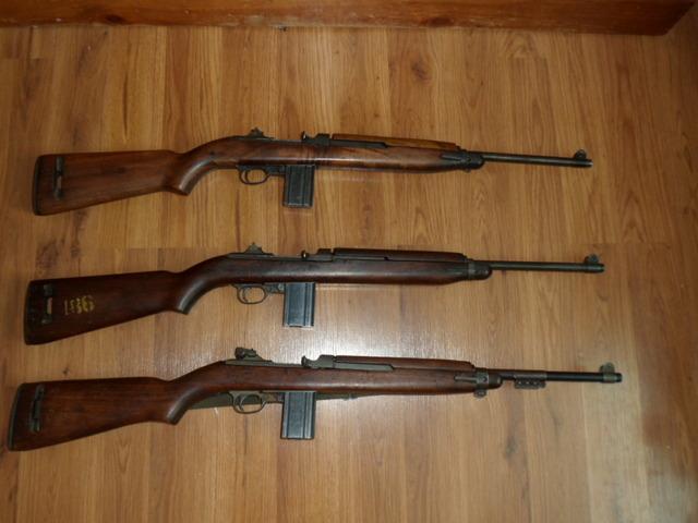

    I have 7 carbines that I would like to find out a value on and to see if the parts are correct. Is this the right place to post or can you tell me where I can find this info?

    Let me start out by saying I know hardly anything about M1icon carbines, so I apologize ahead of time for errors. I bought these guns as a package deal and would eventually like to own a nice example of each manufacturer. I understand some of these guns are probably parts guns and correct so don't think you are going to hurt my feelings. I did the best I could reading the marking and I am sure I will be corrected.
    1. Receiver: National Postal Meter marked with U ser#4344xxx
    barrel: IBM
    Front site: N
    Barrel band: UI no bayonet lug
    stock: marked NPM/TN
    Bolt: N 14
    Hammer: H.I.
    Trigger housing: N 16
    Sear: RI
    Slide: UN
    L type rear site marked NA Right, S left
    2. Receiver: Irwin Pedersen 172xxx
    barrel: underwood 2-43
    front site: EU
    stock: S'G' IR-IP
    butt plate: IP-PM
    bolt: IP
    barrel band: UP overstamped UI, no bayonet lug
    rear site: RP (left) s (right)
    trigger housing: IP
    hammer: S'G'
    sear: SW IP
    magazine catch: IP-W
    Slide: S'G'
    Hand guard: RMC
    Magazine: K-IP
    Recoil plate: SG
    3. Winchester 6562xxx
    barrel: W
    front site: EU
    recoil plate: W
    stock: W
    handguard: W
    Slide: W
    Bolt: W
    Hammer: W
    Mag release: WA M
    Trigger housing: W
    rear site: adjustable circle "h" or "r"
    flip safety
    harms's Avatar
    Dec 2010
    02-12-2014 @ 09:56 AM
    alaska
    6
    05-09-2025
    11:47 PM
    4. Inland 933xxx marked SG
    barrel: inland MFG GM 11-43
    front site: N
    barrel band: UI
    bolt: I.O.
    housing: Inland
    sear: RI
    hammer: H.I.
    mag realease: EI
    handguard: I.O.
    stock: I.O.
    recoil plate: D.I.
    rear site: S
    slide: X
    5. Inland 670xxxx, supposedly a bring back all original
    rear site: adjustable PI
    band: bayonet type KI
    stock: IO
    Barrel: Inland MFG GM 12-44
    front site: N
    housing: inland
    hammer: H.I.
    mag release: EI
    side: PI
    bolt: round AI
    6. Quality H.M.C. 1899xxx
    barrel: buffalo arms 9-1943
    barrel band: UO
    bolt: EM-Q
    rear site: S L style
    slide: UN-Q
    handguard: UMC
    stock: Q- HMC
    Hammer LT-Q
    housing_ Q-NL
    7. Postal Meter 4167xxx
    barrel: Marlin
    Front site: 4
    barrel band: UI and UN
    stock: TN
    slide: N 13
    housing: N 16
    hammer: NH
    sear: N
    magazine release: EI
    bolt: N 14
    handguard: TN
    rearsight: S
    Thats all I could find. I have pictures of all parts but did not want to clog up the forum with a hundred pictures so if I need to post a pic let me know of what.
    Thanks

    Sure you know nothing about M1icon carbines? Those appear to be substantially all correct based on your info. An Irwin-Pedersen is the Holy Grail of carbines, sells for several thousand dollars.

    It appears you have really nice carbines. Mostly correct to original. Most advanced collectors do not have that many correct carbines. A quick look tells me the Winchester mag catch is not right and I don't think the front sight is right either. The others look good. You need to look in the slind well for letters. And pictures of the stamps in the wood on the right side.

    Quote Originally Posted by Bubba-7 View Post
    That is the kind of info I am looking. What would make the gun right? Also, since it hard to give individual prices, what is the whole works worth? I would just like to know if I did OK or not.
