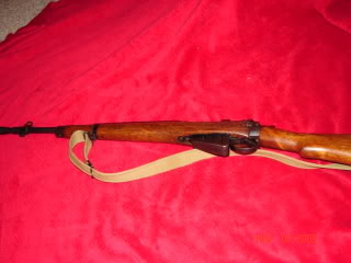

    I just picked this up from my father, and I was wondering about its history or who made it? All I know is that he told me it was made in India. Is it a WW2 era or something that was made much later?

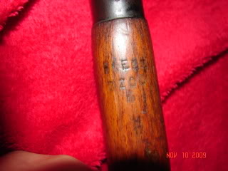

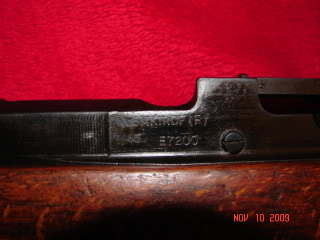

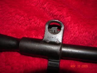

    I checked for any marking and what I do find isnt easily read, so I took a few photos in hopes that someone can help.
    I am also interested in a bayonet for it. It doesnt have to be an original, I just like to have bayonets for my old surplus rifles Anyone know a good source for a reasonably priced one?
    Thanks in advance. Mike

    It appears to be a No5 Mk1 (commonly called Jungle carbine) it was manufactured at the Fazakerly factory near Liverpool Englandicon.
    Original bayonets are scarce and fetch around $200 US
    There are repro bayonets out there, most are Indian copies, some fit and some dont.

    And yes, it's a WWII era rifle. They were made from 1943-47.

    Allan and Steve thanks for the quick responses. What are these markings and how do you know where it was made? I wont be buying another because the ammo isnt has cheap as I would liek and I doub t it will be fun to shoot!!! BUT I am very interested in these old rifle, I have been collecting several WW2 rifles this year

    ROF (F) = Royal Ordnance Factory Fazakerley
    So no, not made in India.
    Some good background info here:
    No5 MkI Rifle
