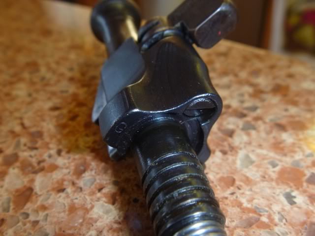

    My SC '03 bolt sleeve is G marked and I have seen several with no marks. In regards to the safety plunger groove the SC 03A3 groove is flat on the fire and safe location and smooth arc on top. The Remington 03 groove is a complete arc with small detents milled out at the 9, 12 and 3 O'clock position that hold the saftey in place. Not sure about the Remington 03A3. If he is asking about the lightning cuts, only the SC has these. Regards, Rick.
