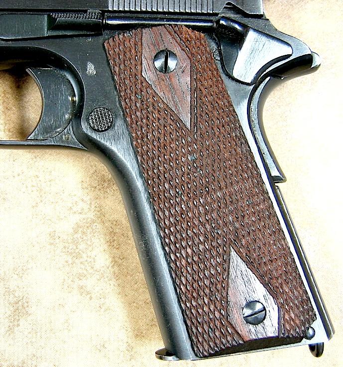

    I'm in the process of trying to purchase a Colt 1911 in the 474000 serial number range.
    After inspecting the piece I found the grip have 13 lines instead of the standard 15 + or - .
    Also in photos some of the diamond checkering does not form a complete diamond in the first row around large diamond..
    I have heard that incomplete diamond's can be repo grips.
    I did find some reference to 13 line grip used for late production of the Colt 1911.
    SO...did the Colt 1911 use 13 line grip in later production and if yes anyone know what range.
    From photo's can anyone tell if grip are OK ?
    Thank you in advance for any assistance.

    Yes, Colt did use 13 row stocks in late 1911 production, and the 13 row stocks carried over the the Government Models of the same period. While the 1911 production covered a large serial number range, it did not cover a long period of time. I don't think this has been known long enough to establish the serial number range where they were first used, but the 1911 shown should fall into the range.
    The stocks shown in the photograph look fine. This is a 533000 range with 13 row stocks for comparison.

    Johnny, thanks for the clarification on the diamond line count on stocks.
    I was more concern about the incomplete diamonds, I could not find any good picture of stock closeups shown the incomplete diamond checkering

    jmoore's Avatar
    06-09-2023 @ 04:20 AM
    US of A
    7,066
    07-11-2025
    10:40 AM
    Interesting to note that both pistols seem to have some verdegris in the checkering of the LH grip.
