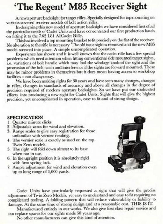

    Hi all, I recently bought a sight on ebay marked: ALFRED PARKER BIRMINGHAM "THE REGENT"
    Anyone know what it fits? I've done all the usual searches and can't find any info on it. I hoped it might fit a No4, but it looks like it wants to go on something with a flat topped receiver.
    Any info greatly appreciated.

    Th 'Regent' was an aftermarket replacement for the lash-up converted .303 No.4 sight which was stuck on the 7.62 L81A1 Cadet Rifles (the same sight which is being punted on fleabay and elsewhere as a "windage adjustable No.4 sight", which it isn't). The Public Schools promptly threw this abortion away and fitted a Regent, or something similar. The Cadet Corps rifles had to remain as they were.

    Thanks Mk VII -
    Great information!
    I re-sized, sharpened and balanced your image in photoshop to make ita little more viewable for us old guys

    Link to it at original size http://www.fototime.com/0ED5B61CD75480D/orig.jpg I get grumbles from other moderators about picture size.
