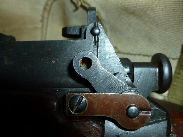

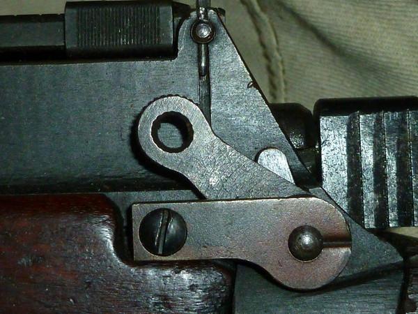

    Two here, both '42 dated and both 4C rifles. One button cocker, one later style. Neither safety is marked, at least on the outer surface.

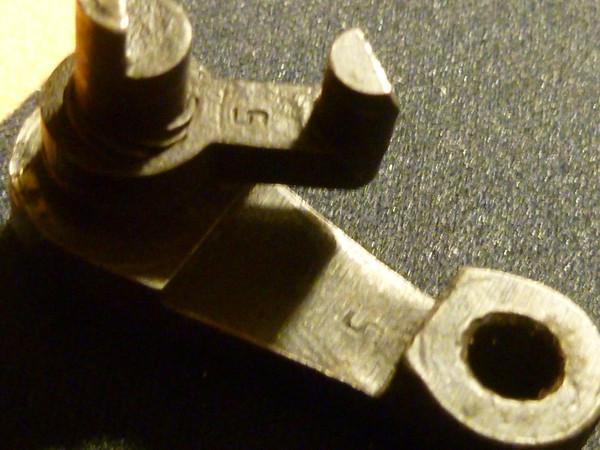

    They're marked on the inside.

    As one might expect, Mr. Dick is spot on. Both pieces of the safety are indeed marked on the inside...

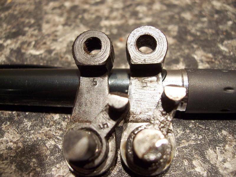

    Here's mine.
