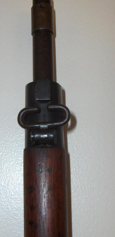

    The gun is for sale. It is a friend of mine who acquired a collection. He is asking 1400.00 and there is no way I can offer that. I don't want to offend him so I will just pass on it and tell him everything I learned about it. Too bad. I really am looking for a correct 1903 to add to my collection. Can someone point me to some good pictures of correct 1903 both low and high numbers? I can find a bunch but you never really know what you are looking at. I would love to do a stare and compare. Also if there other pictures or better pictures I could take to help more please let me know.
    Hopefully the Kragicon he has will be better. I have that gun with me as well and will post in the Krag forum later.
    Thanks for all the replies and help.
    Rick they are definitely pins.

    Is there a small ordnance "flaming grenade" on the foretip of the stock?

    Quote Originally Posted by Rick the Librarianicon View Post
    I assume the foretip is this area?
