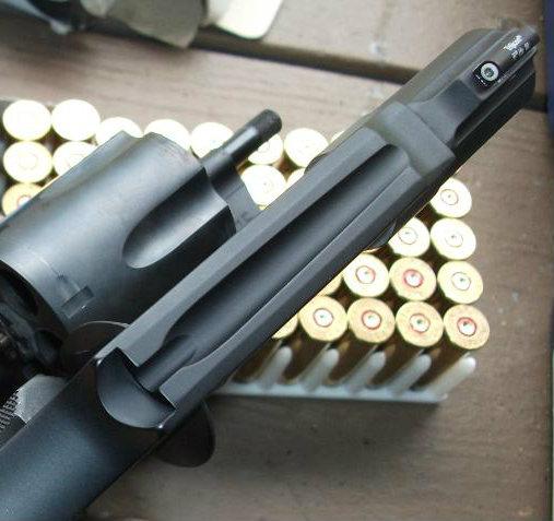

    Tritium sights are my first choice for a carry weapon. Either Meprolight or Trijicon.
    Meprolight sights on the Python:

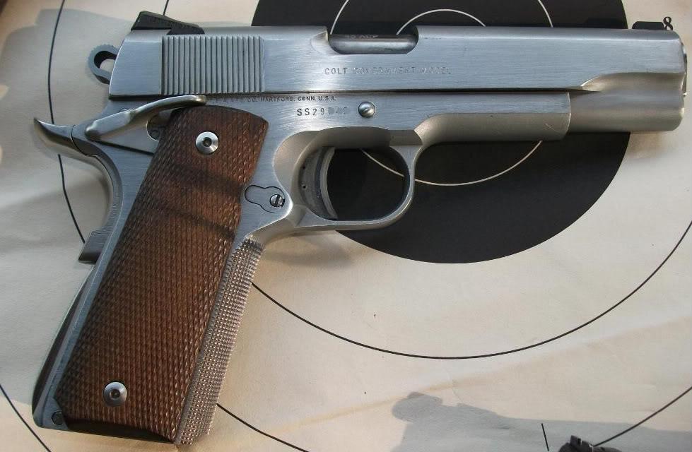

    The G34 has an undergun light. and this 1911 has Wilson night sights which will likely be replaced with Novak night sights sooner or later...:
    Used to do a bunch of night shooting at Ft. Benning, Your normal type sights get useless long before it's so dark that the target can't be seen. Lights are OK, but night sights are passive and last for years w/o maintenance.
