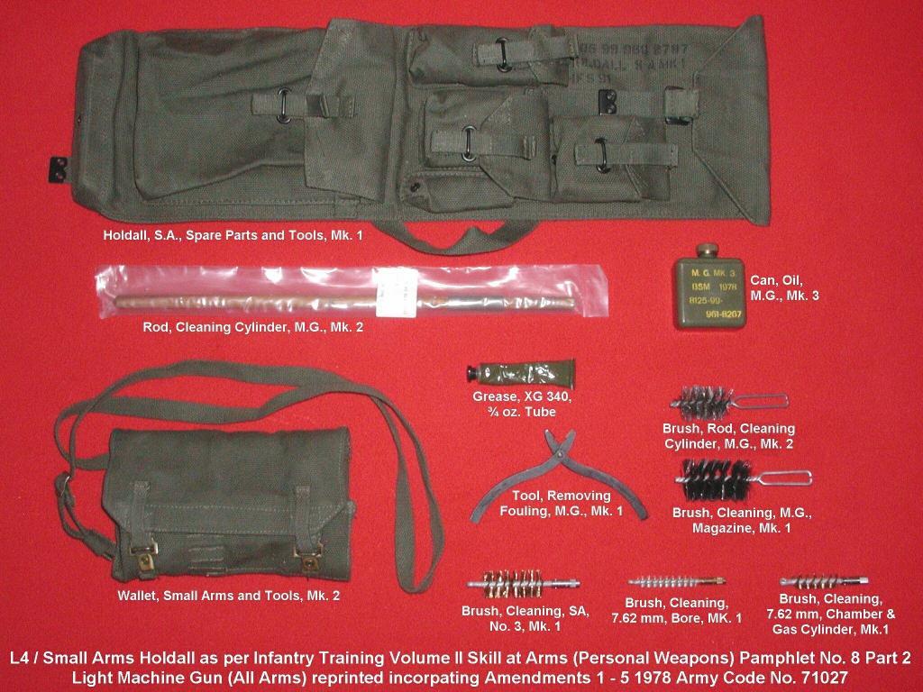

    Hi,
    Having just snagged one on eBay, could anyone point me at a contents list for the above?
    Thanks,
    Mark

    The trouble with this particular question and the reason I have held back from what on the face of it was 'the bleedin obvious' is that there are probably about three answers to this, depending on which Infantry Taining book and/or era you are reading or need to know about. So I'll let someone else be the stalking horse if you don't mind

    Oh well, please correct me if any of these are wrong...
    Missing is the barrel you'd have with a A1 gun, etc etc
    The plastic box is debatable but since I have found them in issued kits that no collector or dealer has had a go at I thought to include it, a green painted tin one would be more correct.
    Cant think of any other "sets" that used the holdall. Theres the Australianicon Roll but that was used on its own.
    ATB
    Tom

    Excellent informative pics as always Tom
    Holdall also listed in the 30 cal BMG IPL.
    ATB Kevin

    Where is the piston post spring? IT would seem inconceivable that this would ever be left out. It was the one part that DID fail

    Piston post spring is not listed or ammended in Toms sources -
    But is included in the CES of the L4A1 onward's
    ........who proof read the PAMS ?
    atb KG

    The Aussie roll doesn't have any spares at all if I recall right.
    Has anyone come across any amendments to the PAMS I may have missed at the Pattern Room?
    I've several spare piston post springs, should I be poping them into the tins, easy enough to do if they were put in the kits in real life.
    ATB
    Tom
