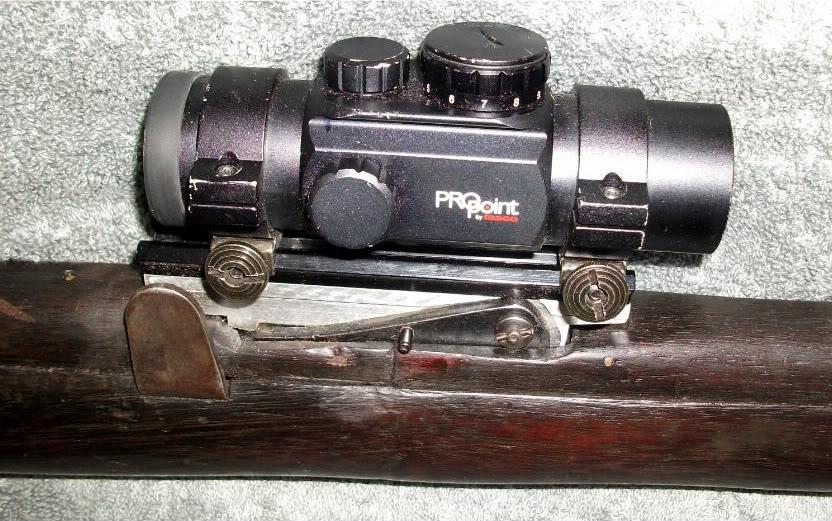

    Alternatives? Dunno. S&K, maybe? The only rear sight replacing mount I have currently is one I cobbled up, but it added a dowel pin through the sight base:
    The rail is screwed onto a hunk of 7075-T651 which was fit carefully into the recess. (Light press fit as installed.)

    Well JM, I do confess that you typically have to wedge the thing between the sides of the backsight ramp, with a slip of copper or brass shim, otherwise it tends to rock on the very short pin axis. But for the terrible 98-family open-V sights, it is still better than my eyeballs. In the case of the Swedishicon Mauser, which has a much better backsight leaf and blade then a K98icon, I agree with you.
    ---------- Post added at 07:45 PM ---------- Previous post was at 07:42 PM ----------
    That is where the B-Square fails, and why one needs a shim.
