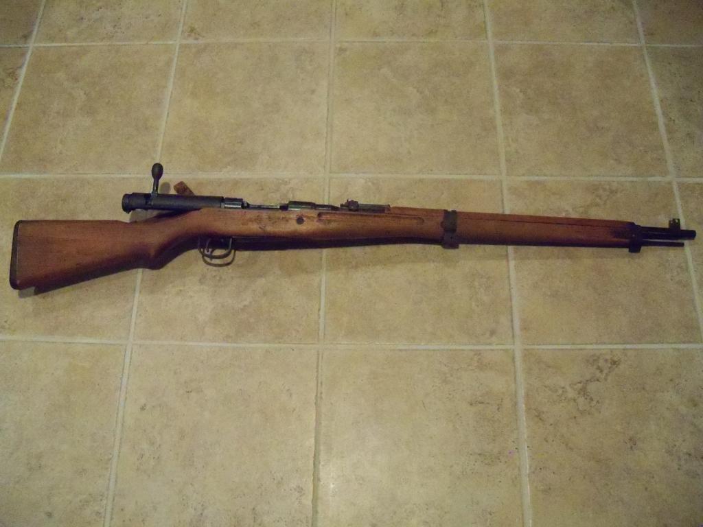

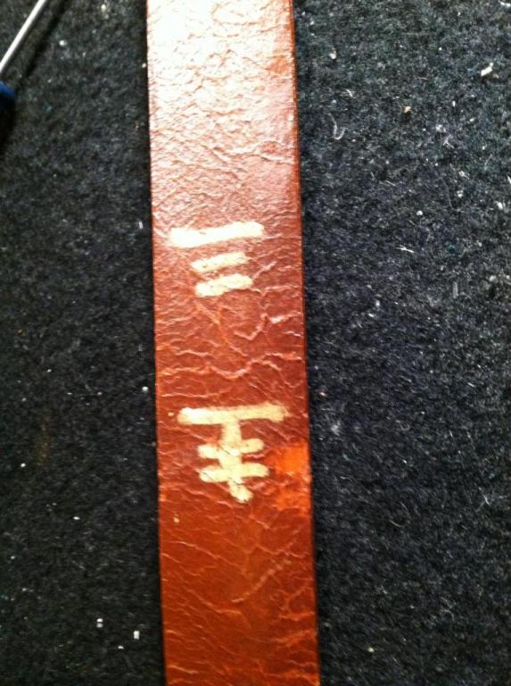

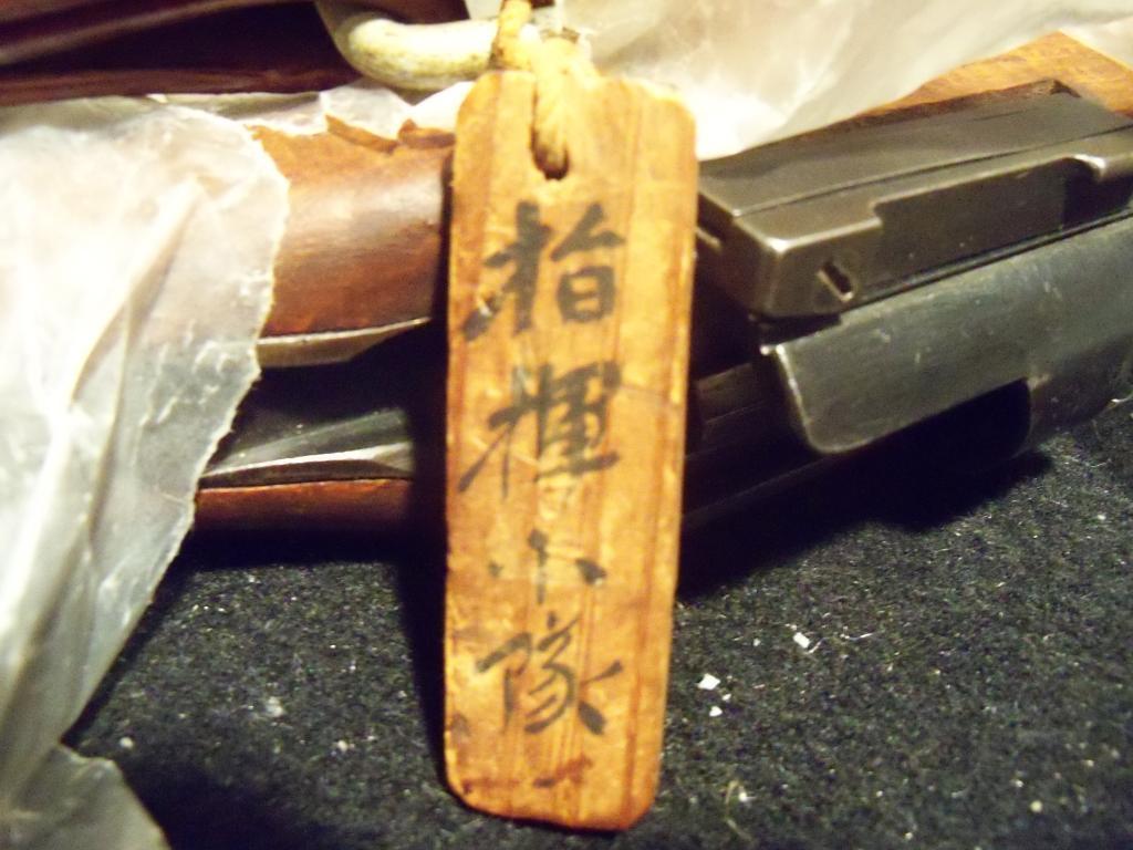

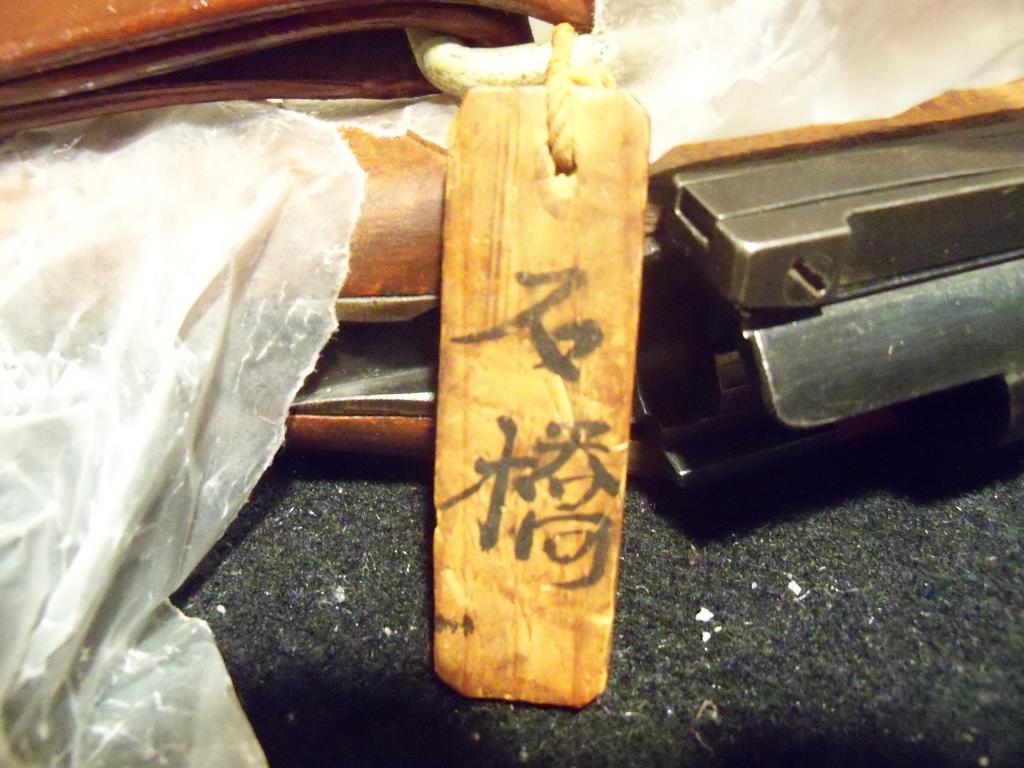

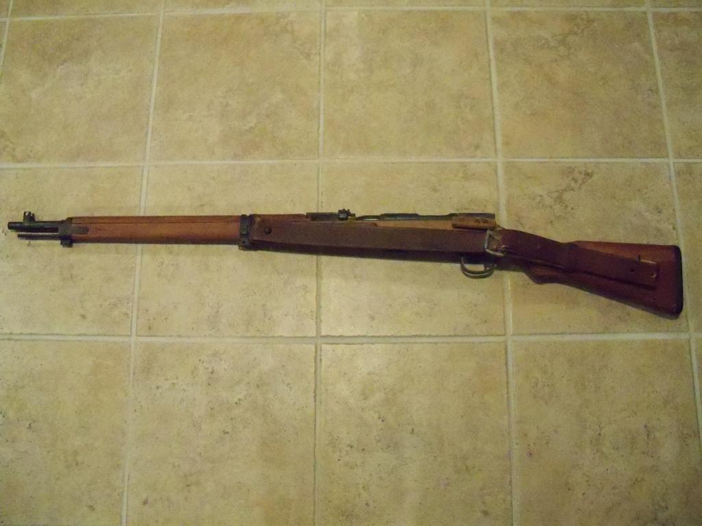

    Good evening all. During my quest to add an Arisakaicon to my WWII collection I stopped in to a local pawn shop. There was a T99 there that a friend told me about. I found it included the dust cover and was completely number matched and had the mum. Very cool! It also had a wooden tag with Japanese writing. The attached leather sling was original but hard as a rock. The rifle is a 5th series Nagoya without the monopod. I don't think it ever had one as there is no corosponding marks on the stock from wear. From another discussion board a member thought the tag read "Platoon Commander Ishibashi." I found markings on the underside of the sling that have not been translated. An effort to soften the sling with Pecards failed, so I am leaving it as is, although when I fired it the hard sling made somewhat awkward and uncomfortable. I can't figure out how to post pics to this original post but will try in a reply. If someone can confirm the original translation I would appreciate it as I would a translation from the sling. Online translators have been no help. I am hopeful the sling markings will be unit information so I'll have a better chance at terracing the rifles history. Best regards - Bob

    Your translation of the characters are correct. Shiki Shotai = commanding platoon. The name is Ishibashi . The characters on the sling is shusan , don't know what it refers to, but translates to third highest.

    You are probably right. Does anyone know the purpose of the wooden tag? I found when I fired the rifle that it has a tendency to try to wedge between the bolt and receiver. I doubt it would survive combat as a soldier would pretty quickly get rid of it. I read in a different discussion group that it was intended to make sure the soldier did not loose the rifle (because it was the Emperors property), maybe, but my firing of the rifle (in my mind) seems to dispute that. I wonder if it was used during long transports so the soldier would be able to get their issued weapon back. I have heard others say it was a "capture tag" but that doesn't make sense to me either. If we wanted to know what soldier had what rifle we could write it down in the soldiers POW file, but why would we label the rifle, and in Japaneseicon?
