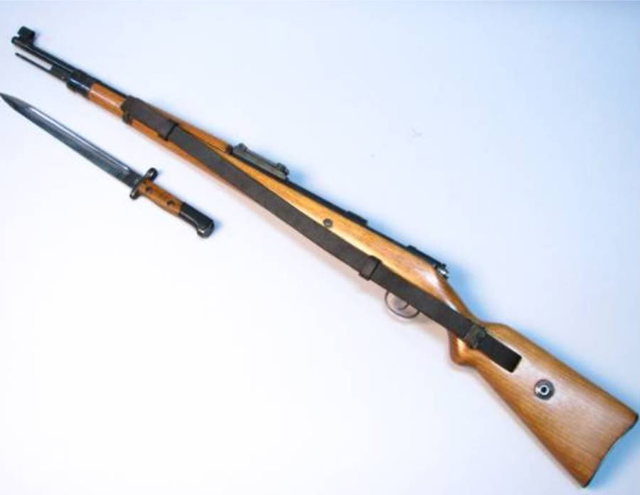

    Here is a pic:
    Still waiting for more info from the seller, but what I have been told is that it has a 2.5.5" barrel, has "42" stamped on the receiver and is 5.4mm. Supposed to be a .

    Hi Steve,
    nice looking rifle. They had 7 makers:
    BSW, Anschütz, Gustav Genschow &Co, Mauser / Oberndorf, Walther, Haenel and the Gustloff Werke.
    Tell us how it shoots. Sometimes it brings funny reactions if you see some guys waiting for the big bang of an 8x57mm and they hear the small noise of the .22LR!

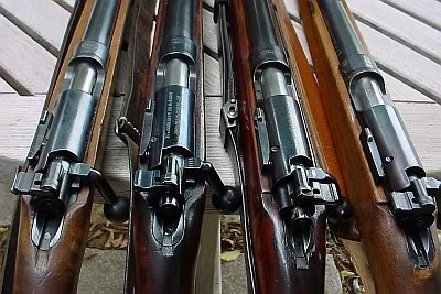

    Kkw
    Calfed's rifle looks most like a kkw (kleinkaliber wehrsportgewehr). However, the picture doesn't disclose enough detail to tell the whole story. The kkw did not have the stock bolt that the pictured rifle has. BTW, Tom in NJ's GW-KKW is very early and shows the crown-B and -U proof marks that were retired in 1940. Below one of each of the four kkw's (BSW, Mauser, Walther & Gustloff).
