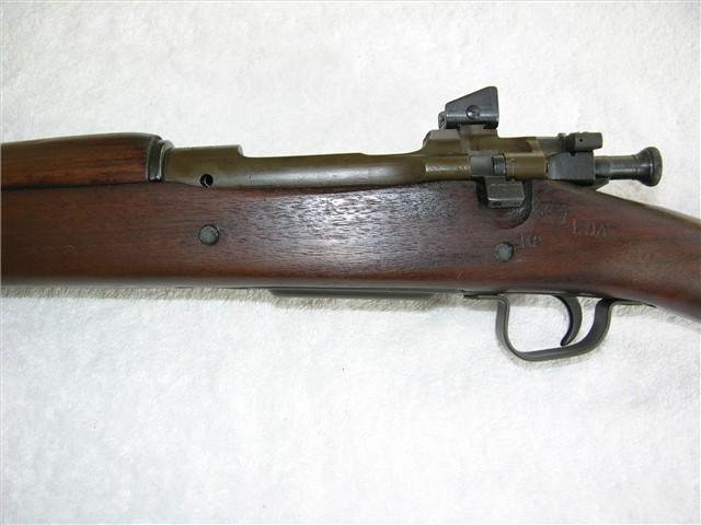

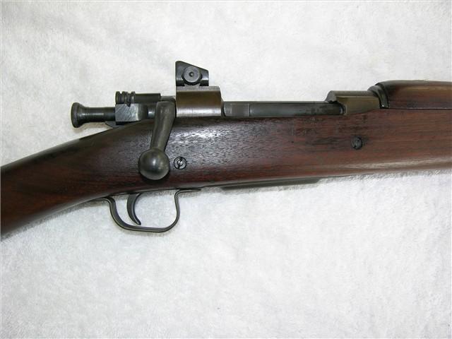

    In any case, I always missed that 03-A3 and recently decided I had to have another. As I only wanted to have one I wanted a nice example. I bought the one pictured on G.B. and it arrived a few days ago. Serial # 4180906 with a RA 11-43 barrel. Jan. 1944 production according to the Remington Society of America web site. I spent top dollar and then some for the rifle but it was what I wanted and you only go around once. The few pictures I have posted were from the G.B. page. I have not had the time to take some good pictures and download them. I will shortly but as I know, without pictures, the rifle does not exist, so these will have to do for now.
    I do have a few questions. About the only part that I believe is not correct would be the sight cover. I think Remington sight covers always had the "R" mark, even if a sub contractor part. The sight cover on my rifle has what I guess to be a part or stock number on the left side ( C64157-4 ) and on the rt. side a letter G enclosed in a triangle.
    Also the stock has the normal small wheel ordnance emblem, the FJA cartouche and the letter RA. I have always thought the RA stamping indicated Remington Arms but I have others say Raritan Arsenal rebuild stamp ???? Also in the sticky there is a post by Harlan from 2-5-10 showing a Remington 03-A3 with what he describes as original and I do not see the RA stamping on his rifle ??

    Your rifle left the factory with a RA(The RA is for Remington arms), Ordnance wheel and FJA cartouches on the left wrist, circle P on the grip. There should be a small R stamped on the front sight, all bands, all rear sight parts, triggerguard, spring, follower, trigger, on off lever, all bolt parts, bolt stop, sling swivels and cubby door on the inside. It should have a Remington buttplate pattern and I am sure I missed some parts. You have a lot of reading to do. Beyond that, about 25 high definition close up pictures would help. Regards, Rick.
