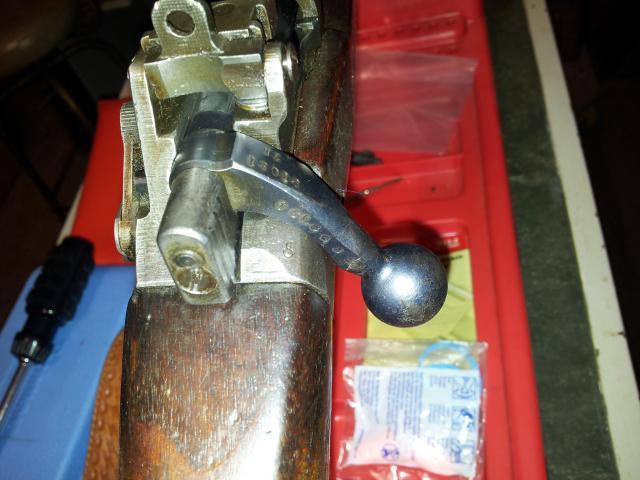

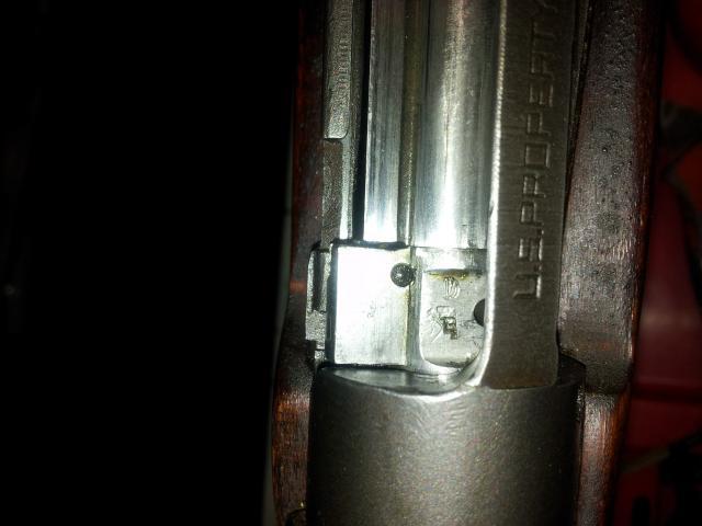

    There are a few markings I'm unsure of, on the safety and bolthead (pictured) especially. I have Ian Skennertonicon's Buyers Guide for the Lee-Enfield, and it doesn't show this symbol.

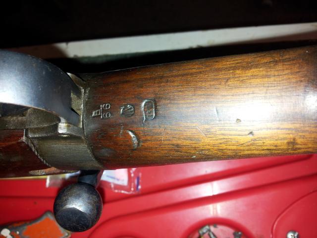

    I imagine the B on the stock is a BSA inspection mark? There are B marks on the rear sight also. 66
    Unsure what the other two marks there are also.
    If someone could let me know what these marking are, it would be appreciated.

    It has been taken onto the books in New Zealandicon during WW2. (the NZ and rack number stamped)
    The "B" on Savage made rifle bodies is quite common; I do not believe that it has much to do with BSA. The "B" on the rearsight could indicate BSA though.

    The bolthead marks seem to be the Savage "square S" and proof/acceptance marks.

    The B is actually an LB for Longbranch. The C/|\ is a Canadianicon Government ownership stamp. Search "Longbranch No4 Mk1* ".

    Thanks, I figured based on the NZ marks that it went to them at some point. Also, the two different serials are on both the bolt and socket, so I take it that the serial was changed in NZ ownership?
    So that's the mark that looks like a box with a tail on it?
    There seems to be a D or something there closer to the bolt body, does it mean anything?

    The NZicon rack number is stamped in addition to the original serial number.

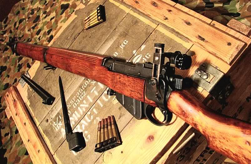

    Thanks for the info. So the sight would have been something like this?

    Your photo shows well how the stock is shaved to clear the side-plate mounting for the Central sight.
