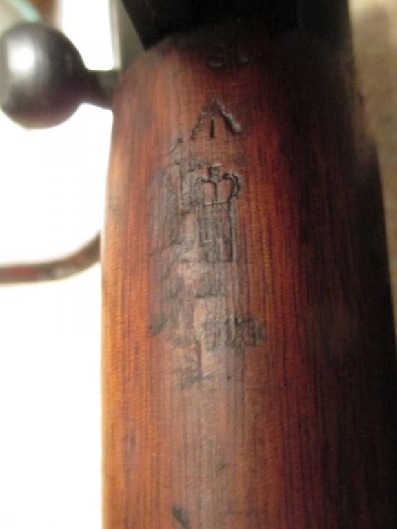

    here is more pics. yes, bolt match but I can see its been double serial (same number) on bolt and on the mag. Butt socket has Englandicon stamp on, Normally, LB doesnt have that stamp right ?

    That's a nice looking rifle...no problem there. And no, Englandicon was a later marking.

    What you've got there is a rifle that had its bolt replaced, probably during FTR as the number was added by electric pencil. Then at a later point someone restruck the SN on the bolt handle with stamps over top of the electric pencil SN. Notice the file marks where the original rifle number was erased. At least they used a Long Branch bolt as you can see the "LB" stamp under the first "5" of the serial number.
    The "(F) FTR" marking would have been "in the white" originally so the rifle has been refinished since then, or at least the lettered area has been.
    Butt is UKicon production also.
    From the wear and the date that rifle may have had an interesting war!
