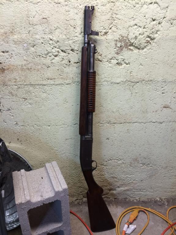

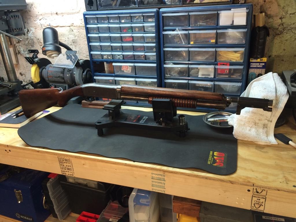

    This reply is for anyone who happens into this thread as it was posted quite some time ago. I finally finished my Model 10 project and here is end result:

    Nice looking old gun. I had one years ago but didn't shoot it as it was just too unreliable...just an old field gun. Mine was way harder looking though...
