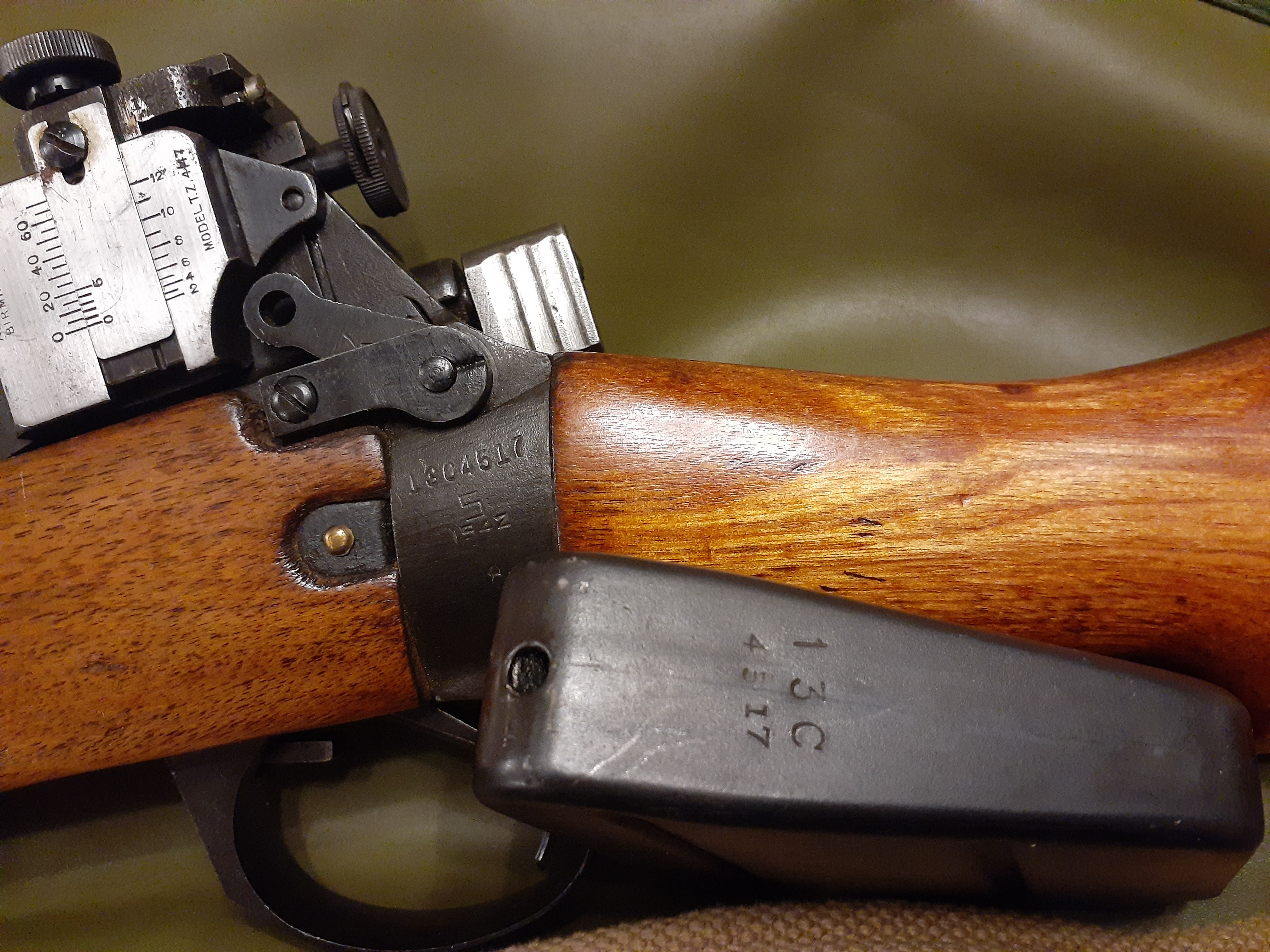

    The message obviously got thru to the armourer responsible for my 1942 Savage. It has both the forend and the magazine numbered.
