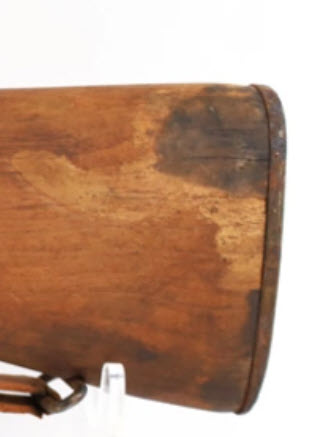

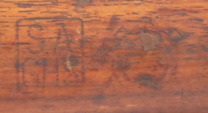

    Jim, can I ask you a favor to look up serial 450348 looks like a 1942. The stock has SA GHS stamped in it, but it looks like the at the heal of the stock has water damage, recoverable but still not great, the buttplate is rust city, the rest of the rifle is very good,

    Nothing in SRS #1 even comes close Bill. I know other guys here have later SRS tables...maybe there's something else has come to light?
    I did look up all the numbers on your list before...nothing on any of them.
    I was just looking at that rifle and from it's pics might be a pile of original parts...might be a good deal.
