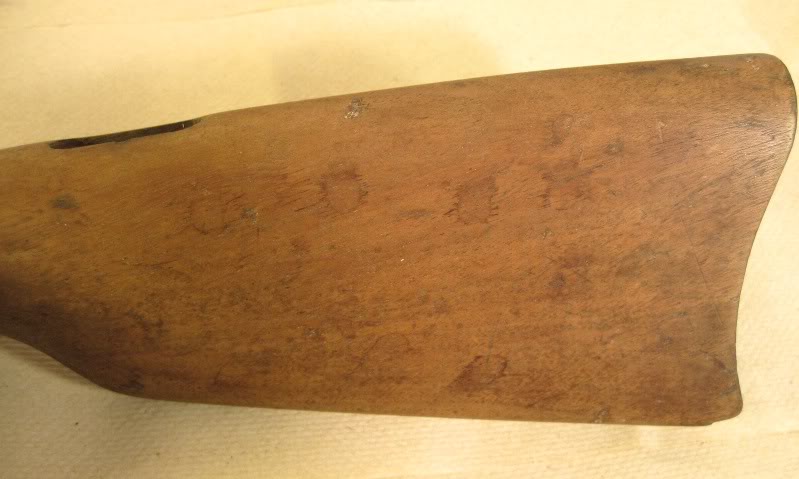

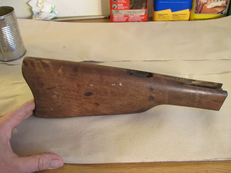

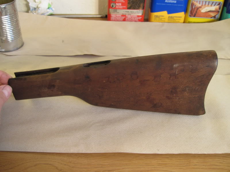

    The Thanksgiving holiday is winding down so I’m now able to start refinishing the stock.
    The stripper instructions suggested a well ventilated area and a temperature range of 60F-80F.
    The outside temps have been well below freezing so I set up a bench in the basement next to an open window and started a rip-roaring fire in the stove. The nice thing about the stove other then keeping me toasty warm was that I could quickly dispose of chemical soaked rags and keep most of the lovely aroma from drifting upstairs. It must have worked since the Wife only lightly complained, once or twice.
    Here are a couple before pictures of the butt-stock.

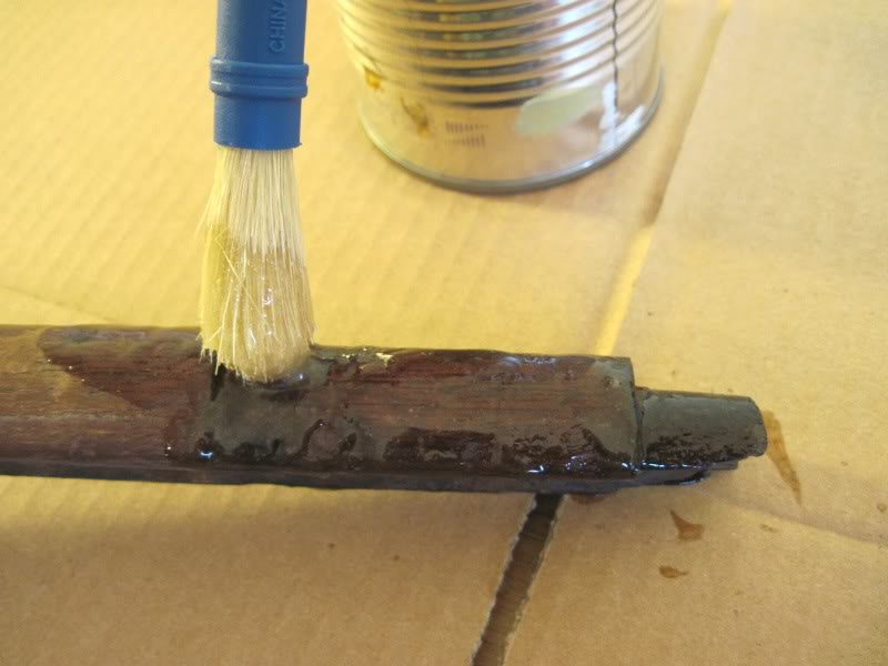

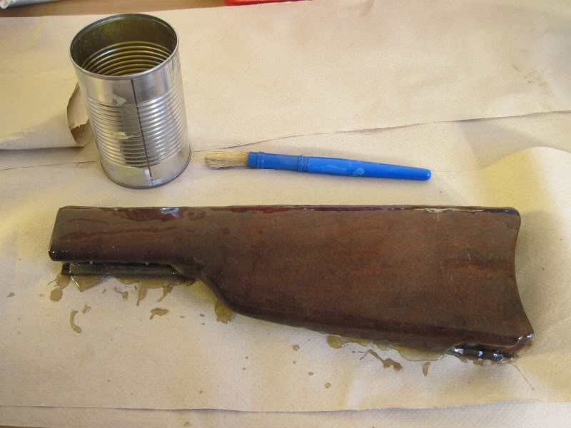

    I swiped a natural bristle brush out of the Wife’s craft drawer and proceeded to slather on generous amounts of stripper onto the wood.

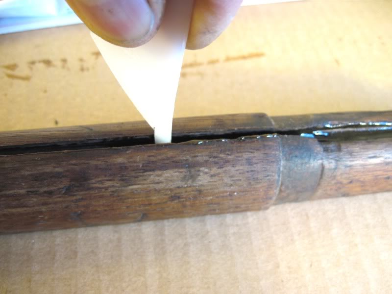

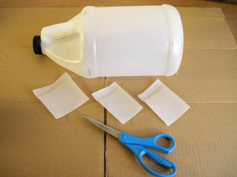

    I left the stripper to do its thing and cut some scrapers out of an old plastic jug. Just to be sure, I dunked one of the scrapers into the stripper can and it didn’t melt. On the other hand, my gloves did.

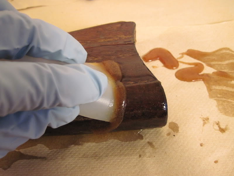

    After the required half hour I donned a more robust pair of Nitrile gloves and began scraping off the bulk of the stripper. The jug material conformed nicely to the stocks curvature.
    A special scraper worked well on the cleaning rod slot.
    Any remaining stripper was washed away using a rag well drenched in alcohol.

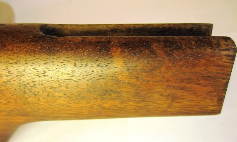

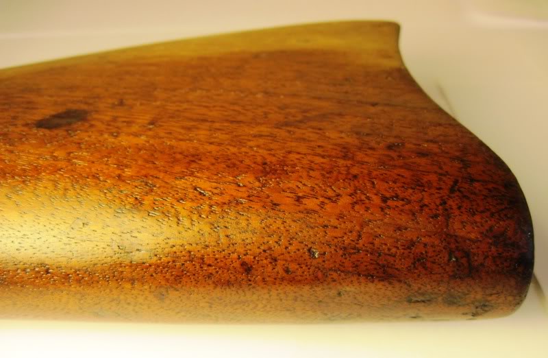

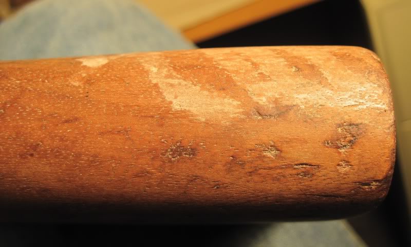

    Unfortunately the results were disappointing. No amount of scrubbing would remove the stains. Even a good drenching with acetone was not able to remove them.

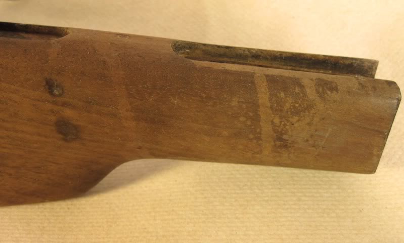

    Here are a couple close ups of the stubborn stains.
    The two dark spots appear to be cigarette burns. I didn't expect them to improve but why no improvement on the stained areas? Sure wish I knew what was spilled on the stock. At least then I might know what would dissolve it.
    I’m really not looking forward to using more aggressive methods but it appears I must.
    The thought of bleaching and staining is distasteful to me. I much prefer natural wood tones. I do have some "Goof Off" that might work. It has all of the required nasty chemicals of paint stripper but lacks the gel thickener and may penetrate better. I’ll test it in an inconspicuous spot and see how it works.
    So, Patrick, what do we try next?

    The wood looks as if it basically has a good surface.
    Quite right: cigarette burns will not disapper. Carbon remains carbon, whatever you tip on it.
    And the rough depressions in your last picture can not be removed without sanding, which is the last thing I would want to do.
    But they do not look like dings, i.e. mechanical deformation, as that does not produce such roughness.
    Are they perhaps spots where rot was starting to take hold?
    If so, those ragged areas will feel softer to the touch than the surrounding clear areas.
    It may be necessary to give those ragged areas a teensy weensy bit of sanding with a 400 grit paper.
    Just enough to smooth them off.
    But try my wood brunishing method first, and you may get a considerable improvement wihout any sanding.
    It is slow, but it hardens up the surface of the wood, and most of that stock should start to look a bit shinier, as I showed on the pics of the ENfield butt.
    What bothers me above all is the drip stains. I do not think that they are stains that you can remove. The reverse is true: whatever it was has already partially bleached out the wood where it ran. In which case, you will only be able to subdue them by bleaching out the rest to match. DO NOT DO ANYTHING ABOUT THAT JUST NOW. Continue with the rest of the wood while I send out a call for help....

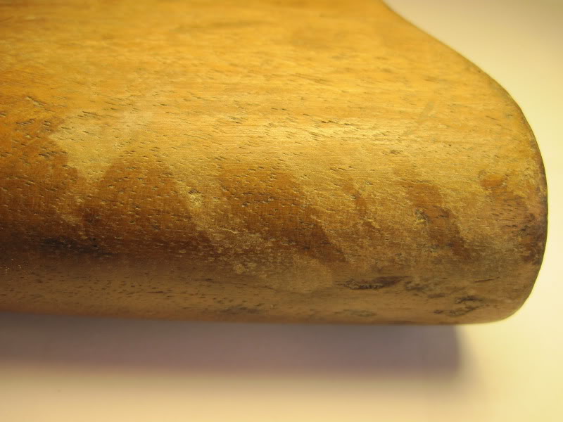

    I had some time to try the burnishing techniques that you described.
    It actually worked quite well and I was able to sit on the couch and watch a little football while madly burnishing away. No need for the Wife to be upset about any mess either since there is no sanding dust. I paid special attention to the bleached runs on the butt-stock. These areas grabbed the burnishing tool and at first did not want to smooth up. It felt like these fibers were slightly softer than the surrounding areas, probably damaged by what ever was spilled on the stock.
    I stayed with it and eventually the tool slipped over the bleached areas with less drag.
    Just for grins I decided to wipe some Turpentine over the area and see how it might appear with a finish on it.
    To my amazement the wood took on a beautiful hue with no signs of the bleached stains.
    Well that got me good and excited so I rubbed some Turpentine over the stained tang area of the stock with hopes that those stains wouldn’t show either. It doesn’t look terrible but it does show. I would prefer that the stains be gone but am willing to live with a few warts to remind me of where this rifle came from.
    I look forward to any suggestions that Claven2 might add to your helpful advice.
    Thanks, Joel.
    Oh, Yah, the dings that you mentioned are firm with no signs of rot. As you can see in the picture above, the burnishing improved their appearence a good amount.

    I think the light areas might be where the concentrated gel stripper was first applied and stayed on a bit longer I would suggest giving it one more stripper coating and then taking another look.
    IF you have to use 400 grit paper, cut it into inch-wide strips 8" or so long and wrap it around a file to guide your sanding. Do not just use hand pressure as this will give it too much waabi (in other words make the surface wobbly). Do NOT sand the entire stock - just sand spot areas where you find more problems than you are willing to live with.
    Personally, if it were my stock, I would re-strip and then finish it - leaving any remaining discoloration as pat of the rifle's history.

    It is very pleasing to see that the methods described here actually work. Initially reluctant to touch the rifle, you are now producing something that you can show with pride.
    We have come so far without removing any metal or wood - we have only removed rust and muck - that we are not going to cut any corners now and use destructive chemicals or sandpaper.
    The gel stripper and burnishing process produces very good results and does no damage to the wood. Another advantage is that since you are not dunking the wood in a tank, you can go back and redo any areas that are not yet satisfactory. We have not yet applied any finish - the wipe over with the terpentine just shows how it will look - permanently - when the BLOicon is applied.
    So do as Claven2 recommends, and redo the area shown in your last pic. The streaks show up more in the darker area, indicating that there is still some grime to come off. Personally, I would try my best not to use sandpaper at all, but if you feel that is unavoidable in patches, then do as Claven2 recommends.
