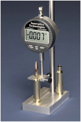

    Ed did a great job of showing several important things that can help you out. The backed out primer shows a fired case with excessive headspace. The case gripped the chamber wall, and it allowed the primer to back out. Great photography . . . . worth lots of words.
    He also showed the RCBS Precision Mic. I prefer to use the Digital Headspace Gauge because it works on ALL calibers, and it does the job of other reloading tools.
    Whether you're loading a .303 Brit. (or a .308 Win.) you should also measure chamber clearance "at the shoulder". Ed's cut-in-half case shows the result when a fired case stretches too far to fill the chamber. This case stretching thins (and weakens) the brass above the web, and it causes headspace separations.
    I use the Digital Headspace Gauge to compare my handloads (at the shoulder) to my fired cases. That's the best way for handloads to fit reliably and get the longest case life.
    If you're not installing barrels (and if you reload), you really have no need for conventional headspace gauges.
