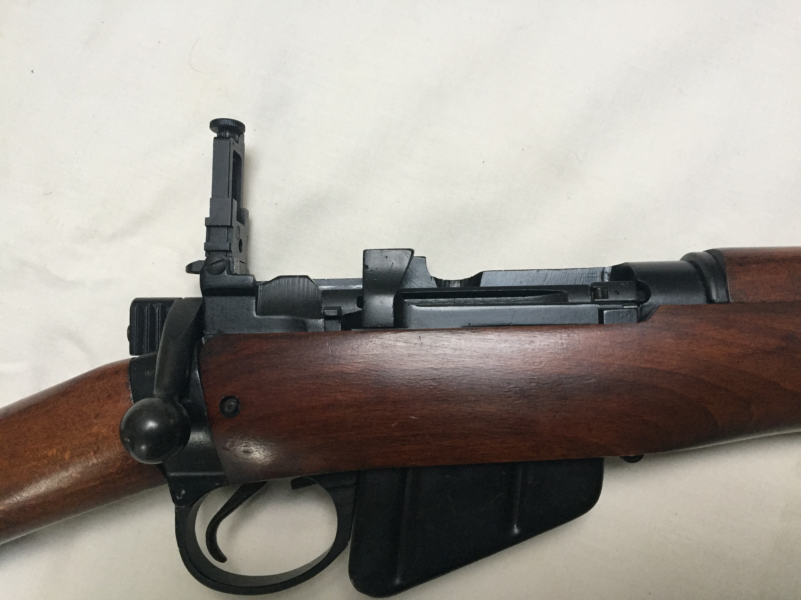

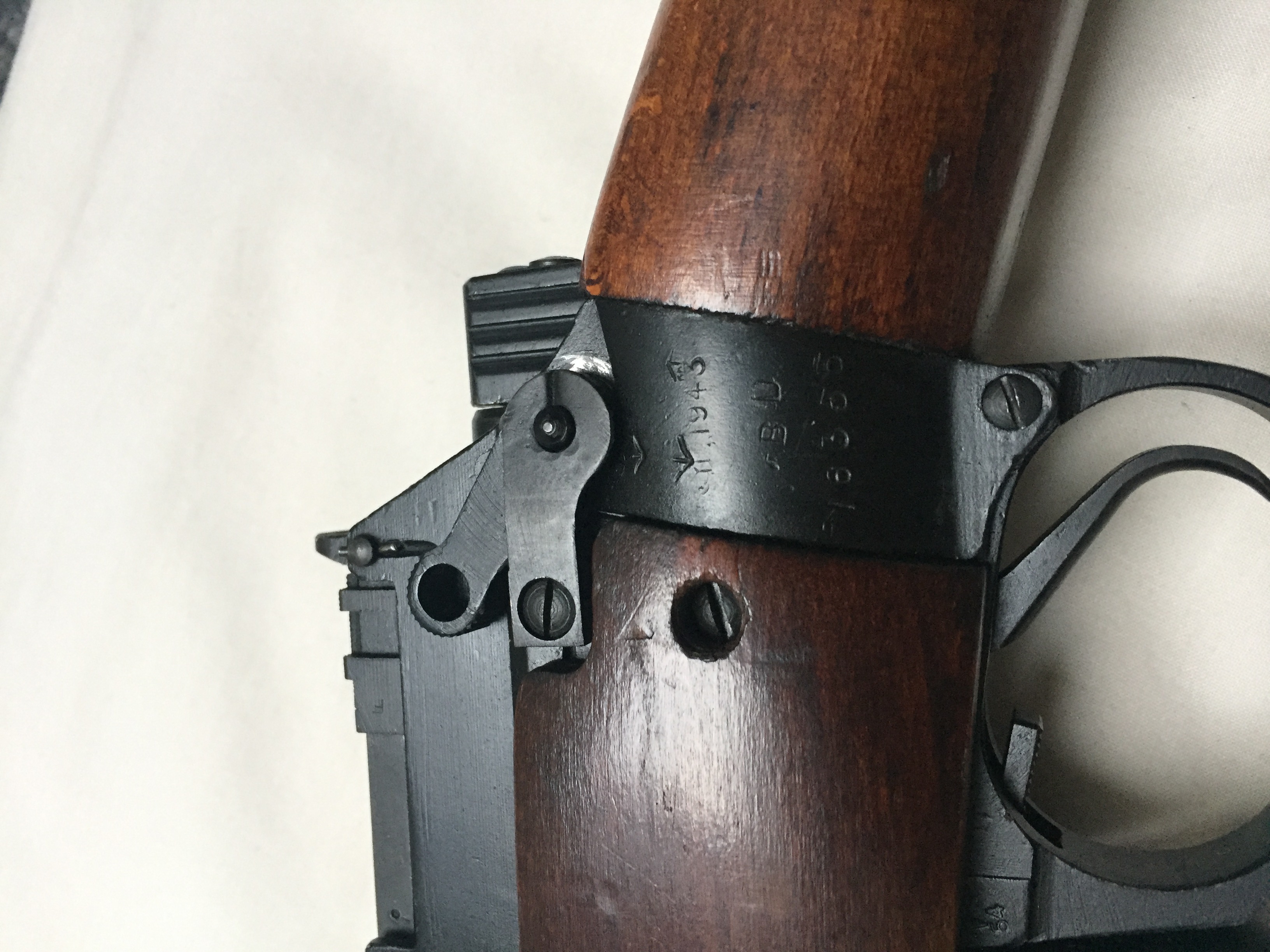

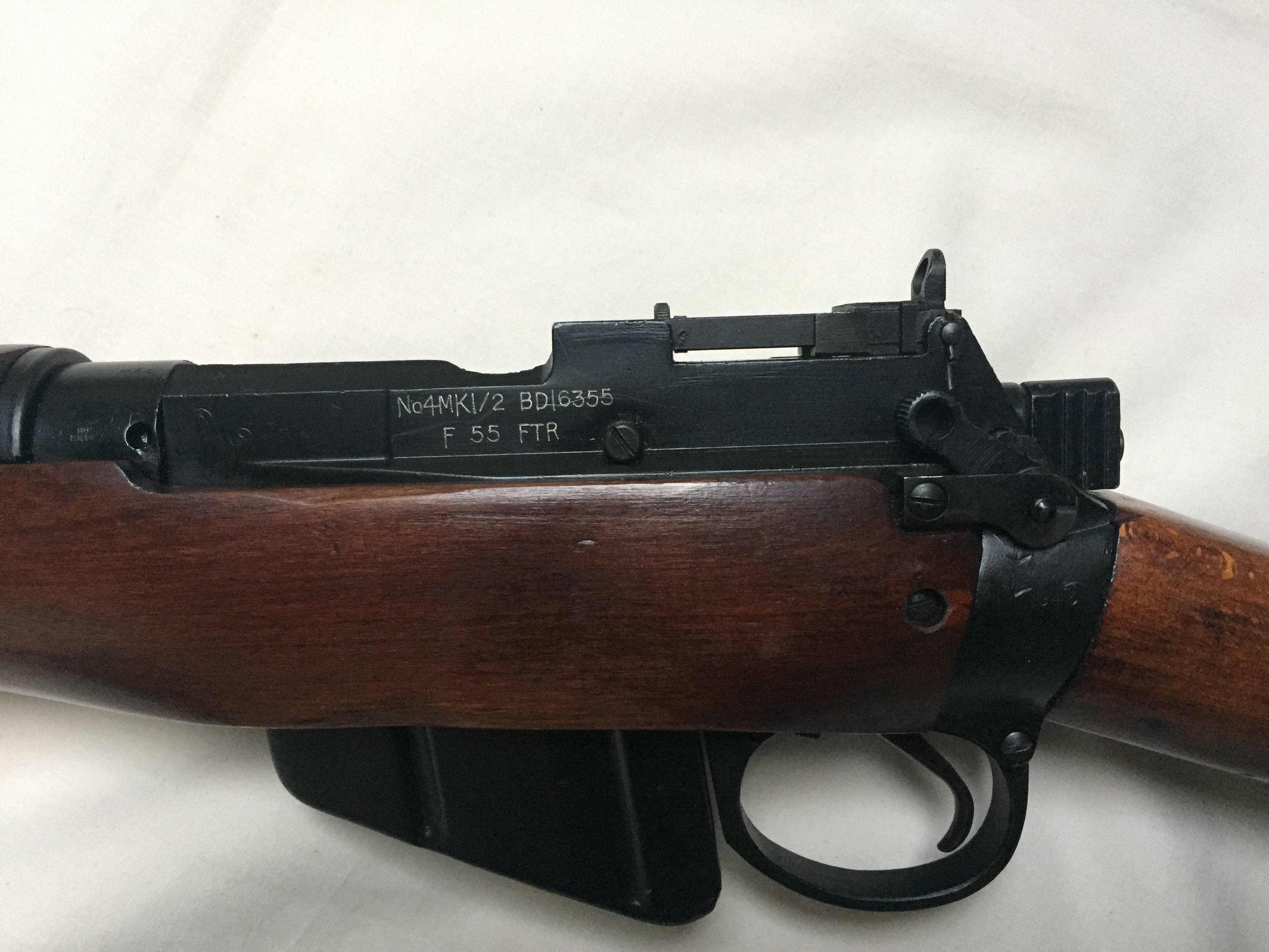

    As this thread relates to a Faz No4 with FTR markings I thought I would add the following. I have a No4 mk1/2 that has Maltby 1943 markings on the action body along with 1955 (F) FTR markings.
    Apart from the action body, all other parts including the bolt and barrel are marked F54 or F55.
    It would appear that the rifle was totally rebuilt using all new parts other than the action body. The bolt, action body, magazine and forend have matching numbers and the rifle looks to be in almost new condition.
    Is this typical of a rifle that has been through FTR?
