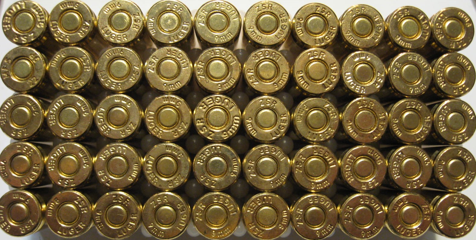

    Nope, it isn't !! I bought 3 boxes of their 9mm 115g about 5 months ago. I didn't really like the look of the taper crimp on them, but the store had (US made) "Ammo-Inc." 9mm and it looked about the same, so figured would probably be OK with it. Another thing I didn't like was the headstamps varied on rounds in the same box!
    At the time, I "Googled" the company name and found a video put out by ZSR - saw some of those same concerns there. "You Tube" reviews varied from very good to horrible! Not sure whether I should shoot any of this or not, but plan to do searches on the lot numbers (each box is different) to see if I find any problems. Here's (2) links to the Factory videos and another by a guy who noticed the headstamps. Also, will attach a couple pictures I took at the time I brought them home. I don't know if they're making all calibers at that same plant in Turkeyicon, or not. - Bob
