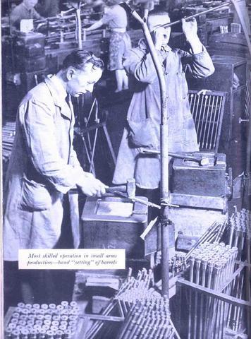

    As I was lead to understand it, during the war, only expensive Bren and BESA barrels were straightened, and that was not by hammer but a press. Relatively cheap Rifle barrels were deemed straight if the last 6" were straight, using a 'GAUGE, testing, straightness of bore' and the 2" long GAUGE, plug bore .301" passed without hinderance.. but a whack of the muzzle onto the work bench was acceptable!

    Barrel straightening at BSA

    Interesting bit of kit, the barrel setter's anvil. Wonder if any of those survived. Note the groove.
    IIRC the TxtBk of SA 1929 says it was done by letting the barrel fall by it's own weight a leather covered block. No4 barrels required a bit more force perhaps.

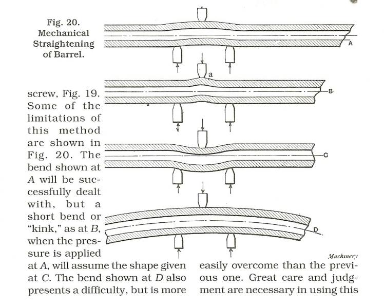

    Straightening Machines
    Again, from "Making Rifle barrels"
    "the writer has tried this method, and can testify that excellent work can be done with the machine, but it is not nearly as fast as the hammer and block method. The impression prevails in some quarters that anyone can run one of these machines and straighten rifle barrels with it, but this opinion is erroneous in the extreme, inasmuch as no one but a rifle barrel straightener can use such a machine ........"
    ".......it is admitted by those who use both methods that machine straightening is not nearly as economical as hammer and block straightening, and that one man can do fully as much work by the latter method as three can do on a machine........"
    Machine Straightening
