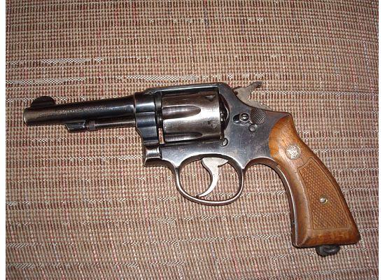

    Victory pics
    Heres a pic. Just a well worn 38 spec model. I definitly don't care for the square grips for shooting but a bit of history anyway. Thanks Truman

    Truman,
    The serial number puts it in the WW2 years, but this one looks like it may have been re-blued at some point and probably had post WW2 S&W grips added, as they don't seem to fit as well as the original smooth walnut USGI grips. Still, it's probably a fun shooter.

    The grips are late S&W model 10 grips. Earlier had a diamond in the center and the ones from wartime were smooth. It looks like a standard model of M&P that may have been a private deal. After all, everyone had them. Even Herman Goering...
