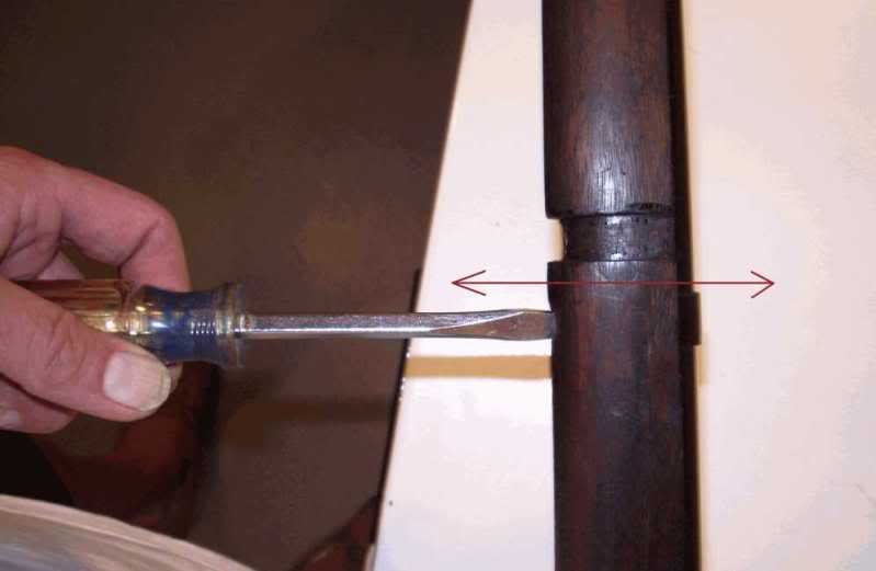

    The inner band screw should only be tightened until spring compression is felt, if over tightened the barrel is pulled down in the middle causing the rifle to shoot high.
    The inner band should only be tightened until spring compression is felt, the inner band acts like a shock absorber helping to dampen barrel vibrations. When the inner band screw is adjust correctly within its tuning range the screw should be free to move up and down when pushed with your screw driver.
    With the nose cap and hand guards removed and pushing on the inner band screw with your screw driver the screw and inner band should move freely up and down. Think of your car tire and wheel being free to move up and down and the movement being dampened by the shock absorber.

    Very slight alteration to Mr Horton's post if I may... The inner band screw should be tightened up to lock. The screw itself has a shoulder at the depth of thread to lock against. This leaves the length of the larger diameter from the shoulder to the head of the screw for the spring, the washer inside the foreend and the thickness of wood of the foreend.
    To test, do as Mr Horton describes above. If it doesn't move, then something else is wrong... not the tension of the screw.
