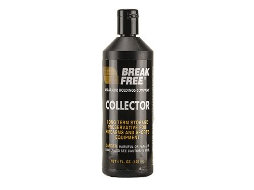

    At $99.95 a pop for these new bags, I'll stick with Break-Free CLP at less than $10.00 a bottle for the same 5 year protection.
    Break-Free CLP "Collector"
    # Developed for the military to protect weapons for up to 5 years in storage, exceeds military requirements for rust and corrosion protection
    # Synthetic oil formulation with multiple anti-rust and corrosion inhibitors
    # Contains no wax or mineral oil, does not have to be removed before firing
    # Safe for use on all metals and finishes
    Look, no bags, no 3in1 oil and NO rust.
