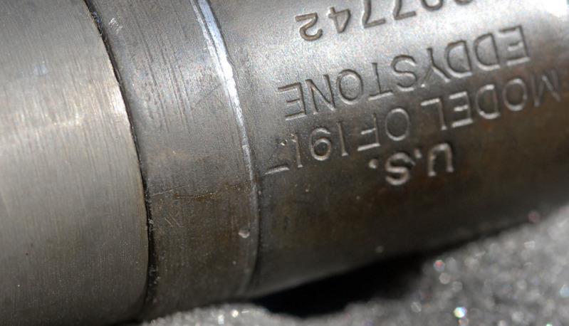

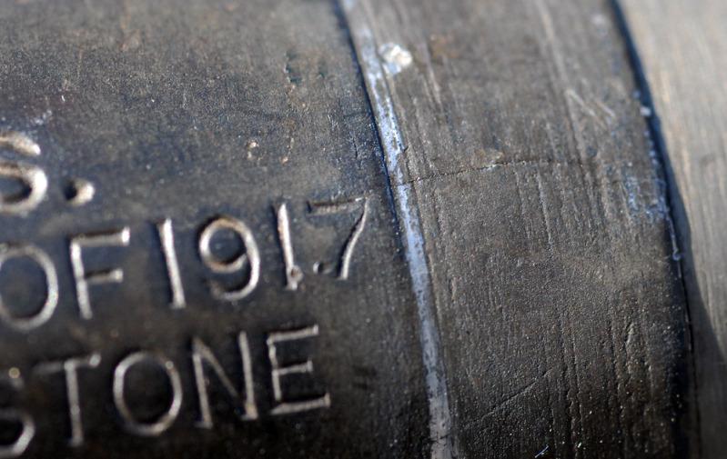

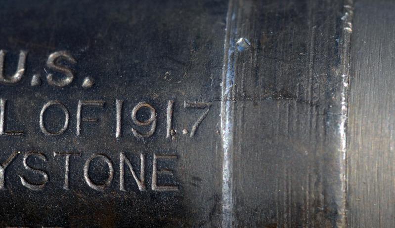

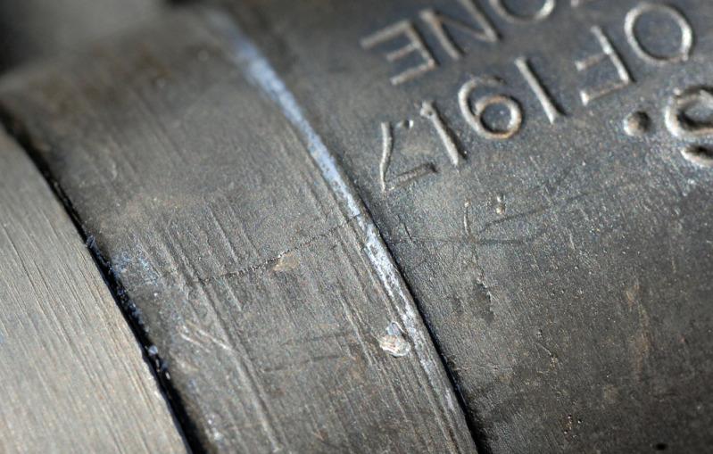

    WHat's your take on this one?
  7. #16
    05-29-2025 @ 09:12 PM
    2,518
    05-31-2025
    04:37 PM
    I think I would have that one Magnafluxed. No reason to wonder at all.

    Dye penetrant (spot check) will work here, as well, if you have trouble finding a cooperative machine shop or engine rebuilder/speedshop. Yiu will likely get some bleed from the rough finish and join lines, but if you follow the direction exactly it works well enough to find even small fractures. Photograph promptly- the dye will continue to bleed into the developer over time.

    old post, but great pics...id say its done....looks like barrel was installed by someone other then the military, notice the finish differance in the barrel and reciever,
    id take Jims advise and see if you can get a crankshaft reuilder to magnufux check it...you will have to completely take the rifle down.
    most car guys like guns as well, and will be happy to help.
    id like to save that pic for my arcives if i may...
    so far 3 1917,s have surfaced in the last year with fractures from barrel installations....{not done by the military}
    thanks for sharing the info.
