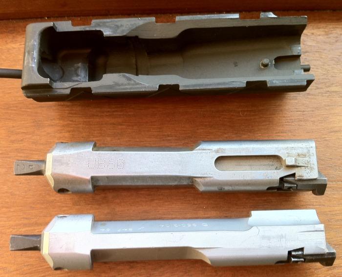

    More irritating pictures
    Here's a few pictures.

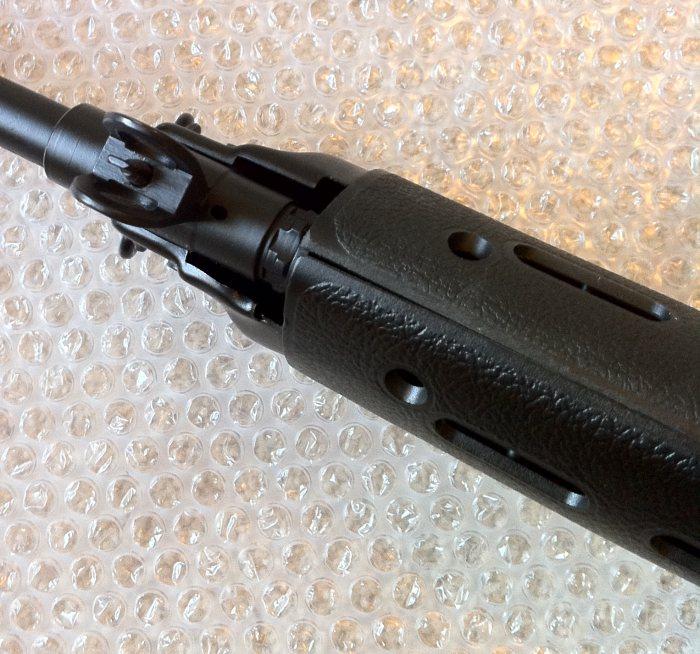

    Very minor niggle, on an otherwise extremely fine looking rifle (haven't fired it yet!), is the plastic above the gas block. I think it's being pushed apart by the new weld, but not quite sure. I've had the handguards off several times but cannot really see what's causing it.
    Note the rib mod on the breech block carrier and a corresponding pin welded in to the receiver channel. Presumably a mod to ensure a S5 block could not be used.

    Bolt Mods
    Couple more pictures of the bolt/carrier modifications:
    Carrier has a pin soldered into it, and a notch cut in the front, and the bolt has a slot milled to clear the pin, and a 'fin' added to the front that matches the notch in the carrier. Both would prevent either being used in a 'real' L1A1 without modification. (Australianicon inch bolt at the bottom for comparison.)
    The gap in the handguards is probably not due to anything in particular - they generally just have gaps! (The Imbel ones seem much worse.) I've seen people recommending taking them off, put strong rubber bands round them and put them in boiling water soften them and straighten them out a bit - but I can't say I've ever tried it!
