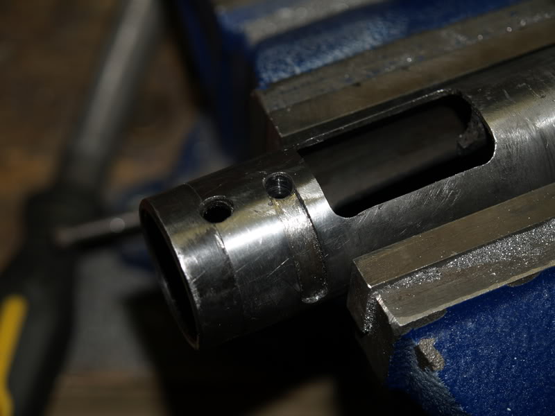

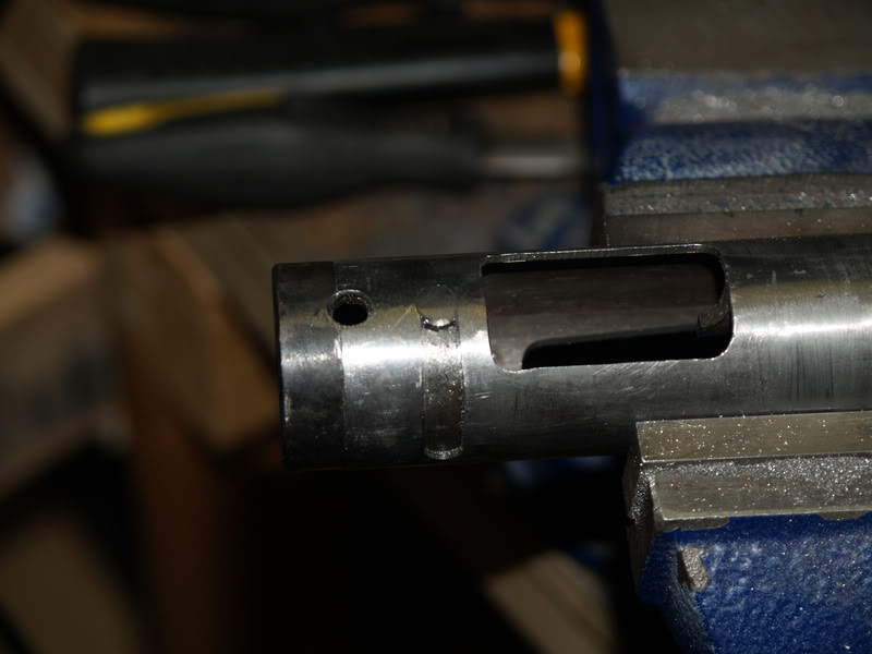

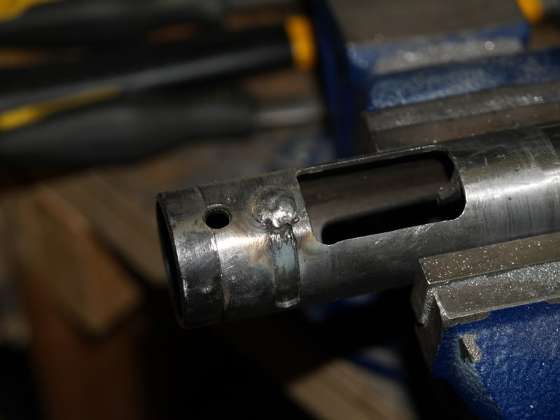

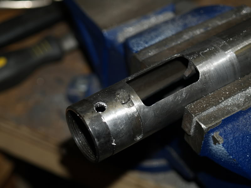

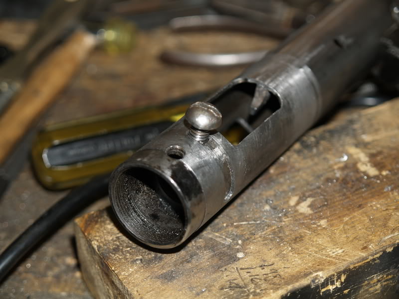

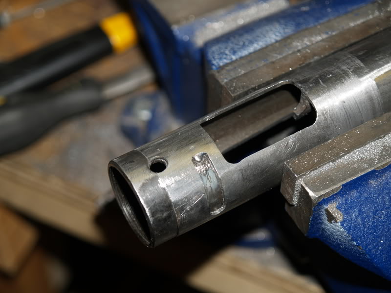

    Time for a little Sten history. Some Sten guns suffered from "droopy mag" which was really a symptom of either a worn out mag well plunger or, more frequently, a barrel nut hole that had become oblong over time. This often meant the scrapping of the gun, or sometimes a puncher mag box or newer, larger plunger pin.
    Since we are not military with many spares, it may pay to fix a droopy mag. Also, this repair can be used to correct by a few degrees if, like me, you accidentally weld in the collar a few degrees off on one of your builds... oops! But we can fix it, we have the technology...
    First we drill out the hole to something larger, in this case 7/16", and tap it. Then we screw in an appropriately sized NON_ZINC_PLATED steel bolt or screw, well coated in permanent lock-tite. Do not tap all the way through, leave the bottom threads tight to get a good interference fit in the hole. Do not go through into the hole for the barrel, stop flush to the hole so the barrel still fits!
    Hack saw off the head and dress it down slightly below flush with a file:
    Now crank up the amps on your MIG welder and giver her a good deep plug welding:
    File to match the tube contour:

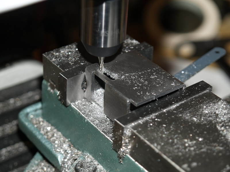

    Re-drill the hole and clean up the channel with the mill. DRILL ACCURATELY AND CAREFULLY. Start with an undersized drill bit and finish drill with the proper size drill. You may have to spot-aneal the weld if it is too hard.
    Good luck!

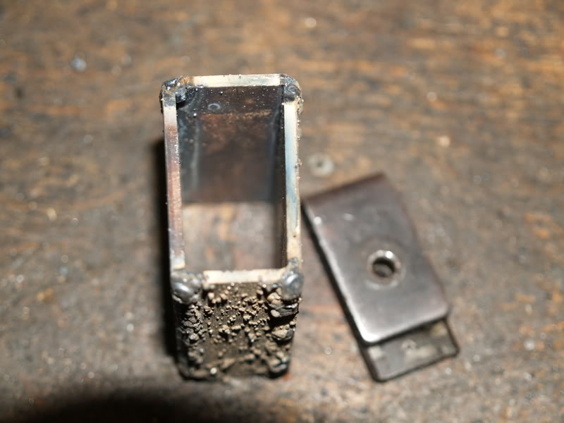

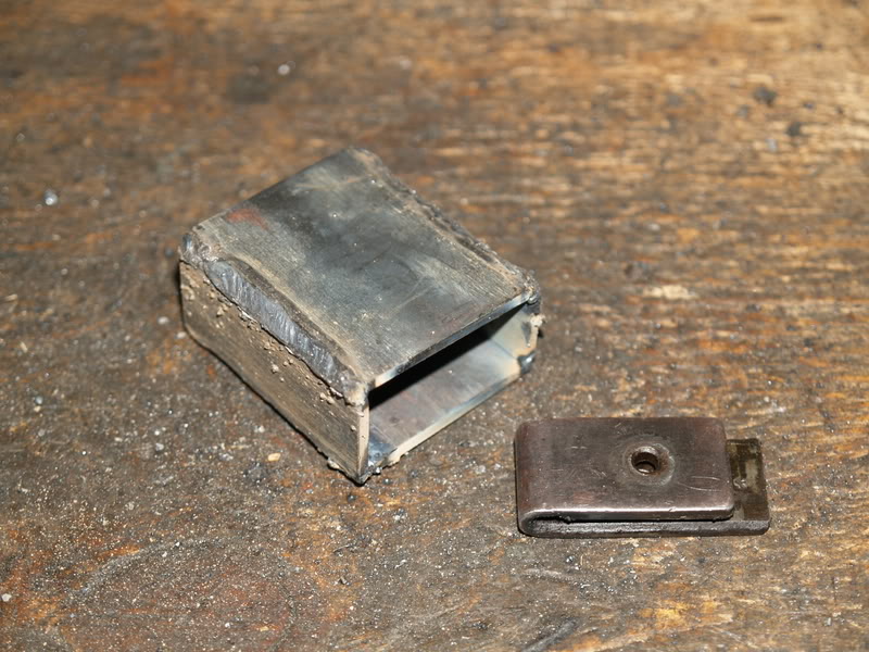

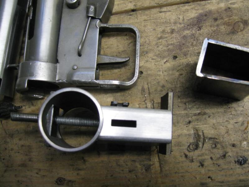

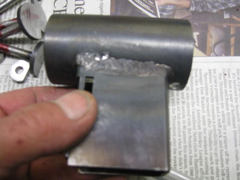

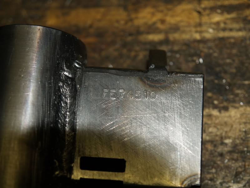

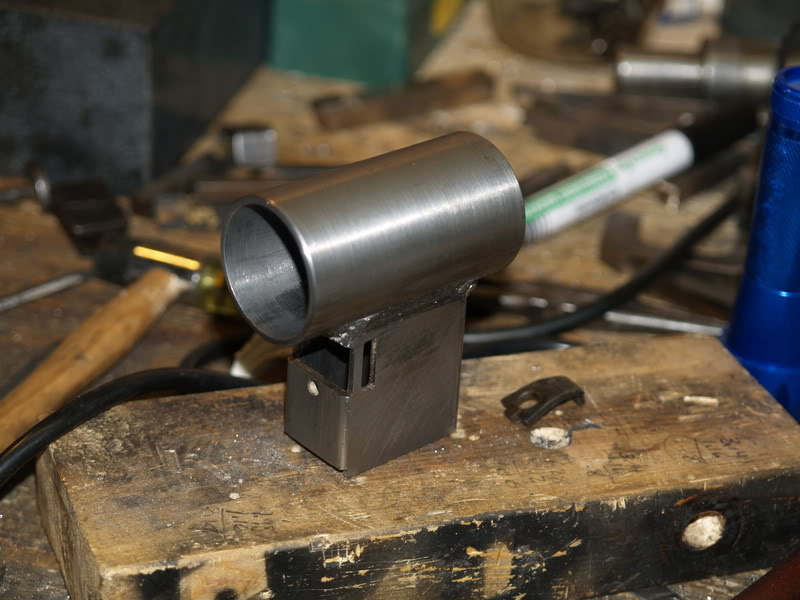

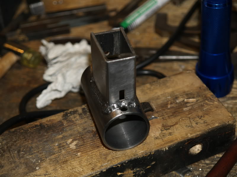

    Here's another mag well build. This time I opted for 4 pre-cut to size pieces of sheet steel plate:
    Clean her up and machine a bit...
    Weld onto a collar...
    This gets easier each time you do it methinks...
    Line up the plunger tab and zap with the welder...
    Apply some markings...
    And presto! ready for ejection port milling...
    Note: This receiver is currently in the process of registration. Some minor fitting remains to be done to make it functional pending registration.

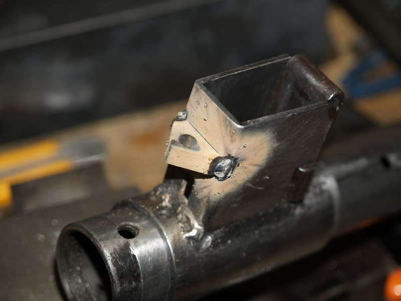

    here are some preliminary design decisions in my quest to devise an acceptable open bolt design. BE AWARE. These design changes ARE NOT YET REVIEWED BY THE RCMP AND MAY NOT GET APPROVED. You would build and submit a gun like this at your own risk as it may get confiscated.
    Here we see a steel block that has been cut to fit between the trigger box wall and the disconnector slot. Coupled with the above-detailed modified selector, the trip lever can now not be readily made to move over to the full-auto position and the steel block welded in from behind makes filing out the disconnector slot nearly impossible:
    And here is the back side showing the plug weld:

    Is that tig welding ? whatever it is it looks neat.
    I have found that by far the fastest way to make the mag well is to use box tubing, it makes a tidy job with minimal effort.

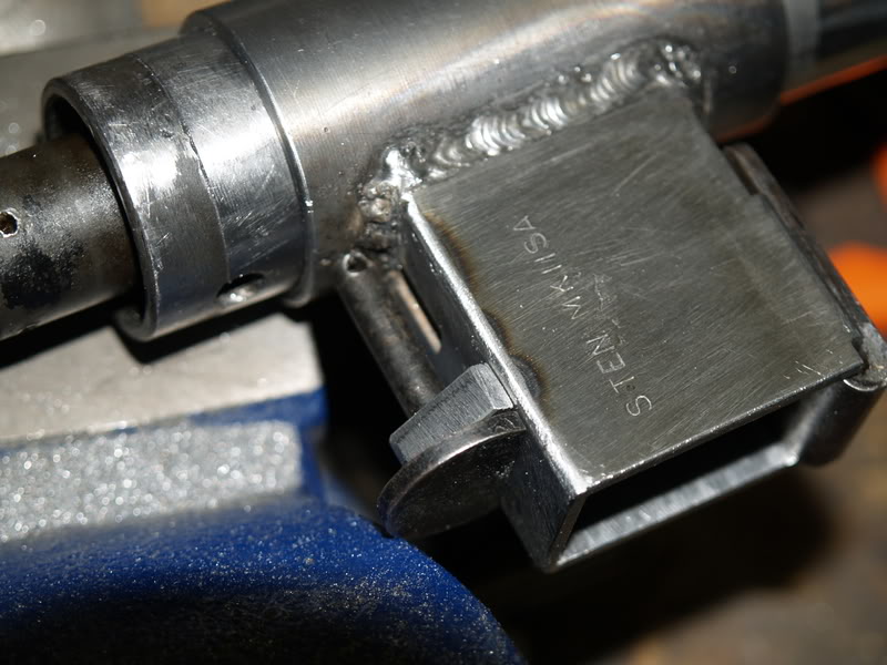

  12. #120
    Banned Mick's Avatar
    Mar 2008
    10-15-2009 @ 03:07 PM
    Saskatchewan
    68
    05-07-2025
    08:14 PM
    Actually, for this latest build, I'm using a 120v Lincoln Electric SP135. I think they discontinued that model last year, but some places still have it in stock. Mine is set up for both flux cored and gas, though in the pics where the weld is spattered in brown residue, I am using flux-cored wire because gas is expensive and I have lots of flux-cored wire lying about, so I only use gas when there is a real benefit to doing so
    TIG is the way to go if you can justify the expense and take the time to learn how to properly use it. For home shops, it doesn't often make much sense though...
    If you can weld like that with a mig then there is little point in getting a tig.
    I have a mig with gas and can come nowhere close to the welding you have done on your magwell.
    PS another thing I'm useless at is stamping the serial number etc neatly, how the hell do you do it ?
    In future I'm not going to weld any visible welds on firearms with anything but a tig welder, a friend of mine welded the magwell below for me with a tig.
