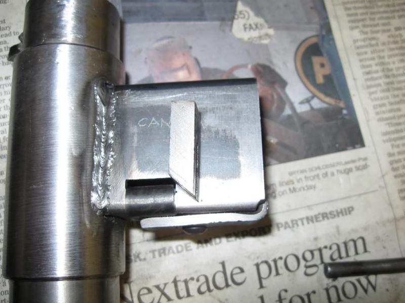

    Mick, the trick with the MIG is to use it at very high power. I have a dedicated 20A circuit for my machine and upgraded wiring to handle the extra impedance. To get good mag box welds, I crank up the power - literally.

    I have done some experimenting with my mig, and no matter what I can not do anything like what you can do with your mig. What you have done looks just like tig welding to me, I'm amazed.

    Generally speaking, assuming that the machine is set for the appropriate amperage, and wire speed, and gas flow are correct, it is a matter of practice, and more practice. I remember when I first used a MIG, there were bits of wire stuck all over the place. One of my future purchases is going to be an auto darkening helmet. Just one less thing to have to mess with at the critical moment.

    Yes, I've seen the mausers in question I kind of know the smith who built them rather well...
    As for MIG welding, technique is a HUGE part of it. You need to build up an appropriately large puddle of molten metal to start with. I then traverse across the joint with a sort of swirling pattern to get a nice thick weld similar to what you get from OA welding.
    My first sten was built with OA, I used mig on this one because a) I have the gear and b) MIG is easier to use if you are practiced enough to know how best to use one.

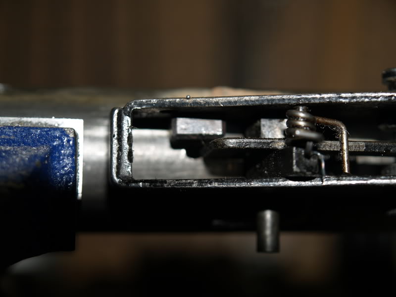

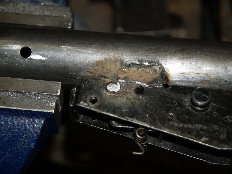

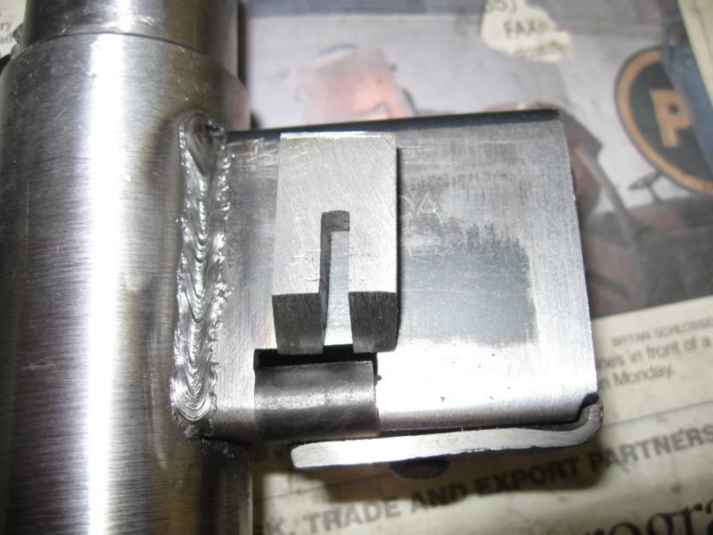

    here are some preliminary design decisions in my quest to devise an acceptable open bolt design. BE AWARE. These design changes ARE NOT YET REVIEWED BY THE RCMP AND MAY NOT GET APPROVED. You would build and submit a gun like this at your own risk as it may get confiscated.
    Here we see a steel block that has been cut to fit between the trigger box wall and the disconnector slot. Coupled with the above-detailed modified selector, the trip lever can now not be readily made to move over to the full-auto position and the steel block welded in from behind makes filing out the disconnector slot nearly impossible:
    And here is the back side showing the plug weld:
    Here's another way of blocking the trip lever.
