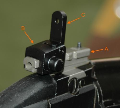

    If the sight is wobbly....., do you mean wobbly left and right? If so, it's the adjusting screws and/or detent spring.
    Because i got my problems with English i try to explain with Picture:
    Part "A" (name??) is steady; part "C" (Blade/Leaf) sits steady; part "B" (Slide) wobbles. When i put some 0,2mm plate between "B" and "A" the whole group becomes stiff.
    Peter , THANK YOU for help

    Quote Originally Posted by Ro-bert View Post
    https://www.milsurps.com/images/impo...6/l1a1j1-1.jpg
    I just came from the shooting range. It was a bit dark, but... My eyes are more familiar with iron sights, so my result are not competent (I must practice a lot), however, my fried has made some below 1" groups at 100m
    PH barrel?
    EDIT - are PH barrel chromed? It is shining like mirror

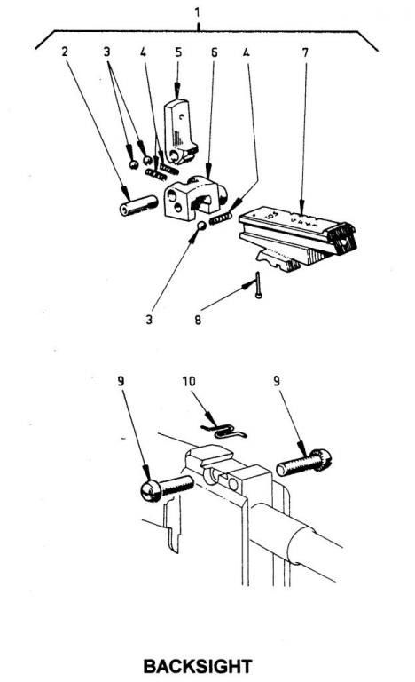

    Part A = RAMP (7)
    Part B = SLIDE (6)
    Part C = LEAF (5)
    A quick fix for your type of wobble is to gently squeeze the sides of the SLIDE together ... by 0,2 mm might do the trick.

    @ nzl1a1collector:
    Thanks for pic & advice! I will report result.
