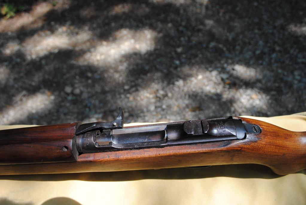

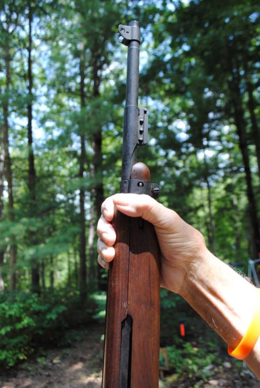

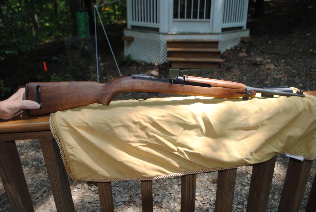

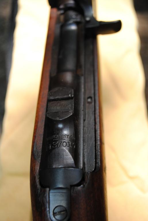

    AnnieO sent me the pics, of which I will post the ones that seem to be of use.
    The carbine looks to be refinished (blued) after the rebuild refinish (Parkerizing) and the stock has been cleaned up and finished. The rear sight dovetail may have been used with a scope mount at some point, but does show the staking for a flip sight. I wonder if it's a Bavarian?

    The finish looks more black then blue. I don't think it's a Bavarian but it is a nice Winchester. And as stated has only the flip sight stake marks so a prime one for restoration but very expensive to do.
