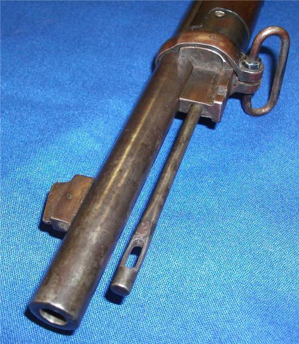

    #11b) Nose cap with bayonet lug details. The projection on the bottom of the cap (as shown on the top of the inverted stock in the photo above) is to restrain the front band from forward motion under recoil.

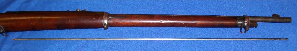

    "Removable" fittings:
    #12a&b)
    #12c
    #12d) Very simple cleaning rod that likely had a loose extention. One piece, with the slotted area slightly flattened. Note the lack of threads on the slotted end in photos 12a and b.
    #12e&f) Two views of the front band, both from the front looking rearwards. The swivel is non-detatchable and retains the hex-headed clamping nut.

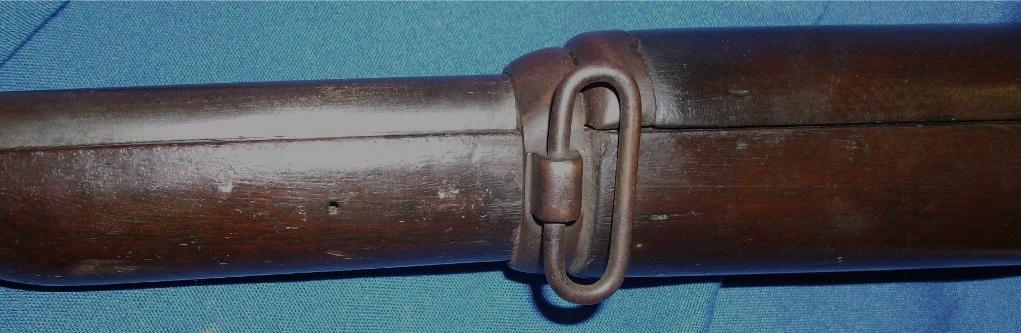

    #12g,h,&i) Rear band. Unidirectional in function, so there's no small "U" marking on the side to indicate the proper orientation. What's odd is that the clamping screw enters from the opposite side as the front band.

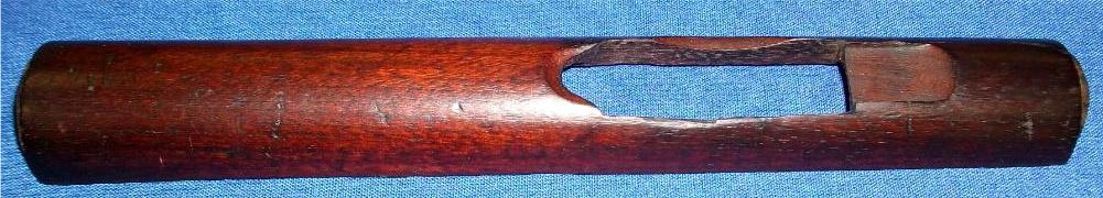

    #12j,k,&L) Simple, no reinforcements, handguard. There's an integral overhang on the front of the action body that retains the handguard rear.

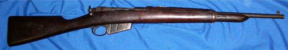

    It's not a US service rifle but here's some preliminary photos of a Remington Lee .30-40 Cuban contract carbine:
    #13a
    #13b: Sorry about the fold in the blue cover obscuring part of the fore end tip- It will be a while before more and better photos can be done.
    #13c
    #13d
    #13e
    #13f
    #13g
    #13h
    #13i
    #13j

    Some more hastily photographed details of the Remington Lee "1899 Model" carbine:
    #14a: No real differences in the action, but there are some differences in the markings from the rifle shown earlier.
    #14b: The bolt head stop arm is installed and is pivoted outwards on this action, unlike the rifle which is missing this mysterious little part. (RH side of the action, just above the locking lug.)
    #14c
    #14d: Note that the side mounted rear swivel appears to be a standard Remington buttstock swivel, just relocated.
    Having a hard time finishing the photos and commentary on this rifle type. Given some incentive, perhaps a bit more progress will be made without a huge delay. Being able to shoot one and having someexpectations as to a good range report would help. But neither of these examples (only one of which is mine) has a good bore- the carbine's is probably the better of the two, but it has a very weak muzzle. Your patience is appreciated!
