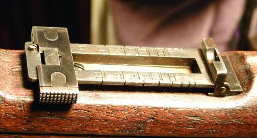

    I think that is the wrong sliding sight or else it has been worked on. I just checked my 1895 and it has the spring clips on both sides, not just one. My sight used to have a similar problem but not as bad and I fixed that by bending it straight. The one side would not engage and because of that it just slid. Works perfect now.
    The two sides of the sliding sight should be mirror images of each other.
    This is not my sight but it is a photo that looks like my sight.

    aaragorn,
    early chilean mausers had just the one spring clip, later in production they began using both sides. i agree patrick there doesnt seem to be any detent, thanks for the advice im still trying to figure it out.
    Yeah, it's my sight and my photo. As in "property of....". I should start sending an invoice when I find my photos being used without permission

    I always thought mine was very early production (B prefix, two-digit s/n), but it has the both side spring clips configuration, allegedly used in later production. So does the B prefix indicate late production? BTW: It is also very deeply blued, ...like a beautiful midnight blue. Other than that, it looks exactly like the 'copied' sight picture posted above (and re-copied below).
