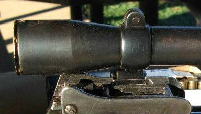

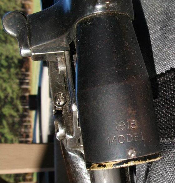

    Valley, that pic is one that I had come across too. I can't remember if it was me who posted it here or I got it from here when you did. I don't have any details on it but I do have a better pic of one and the forum name of the owner, I will track him down if I can. In the meantime, here's the better pic, I will leave it as big as the upload will take in case you need to use proportions to come up with measurements.
    I would think your mate making them would have an idea about how much undersize to make the bit that goes on the scope. It may be a percentage, like 5% smaller than the scope OD. From there, dimensioning might not be too hard. One thing I do recall, the original is tapered in the wall thickness, to near nothing at the back making it very plyable on the eye socket

    The dimension and flair angle of rubber eyepiece etc I obtained from a picture of a side on scoped rifle. Using known dimensions on mounts/rifle to prepare a scale to estimate dimensions, think might have sent it to you before Son? I obviously know scope ocular bell O/S diameter and visible diameter of ocular lens. However dimensions such as rubber wall thickness would be best guesses. I have a few original Britishicon optics rubber eyepieces and original and copy Germanicon WW11 sniper scope eyepieces, the rubber wall thickness varies from 2.10 mm to 2.74 mm however these are for much bigger scope, I would guess Model 18 rubber wall thickness about 2 mm or perhaps under this. I note your comments regarding the tapering wall thickness, but was this taper from the very rear of the reinforcing flange to the start of angle of flair? (Obviously actual flare part tapers). I would have guessed if not told otherwise the wall thickness would be consistent along length until start of flare to avoid drooping when fitted.
