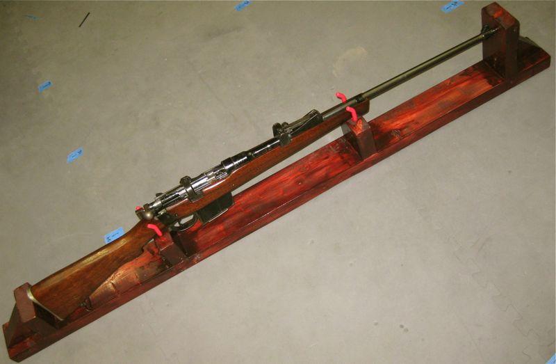

    I gave the magazine lip some love and it now has a slight ramp that improved things greatly. Without doubt the soft lead tips are no help at all, I will ask the range for some better rounds with no steel cases or lead tips. Other than that the rifle continues to clean up, I built a custom rack to hold it while cleaning. Will shoot again in the new year. All the best for 2013!

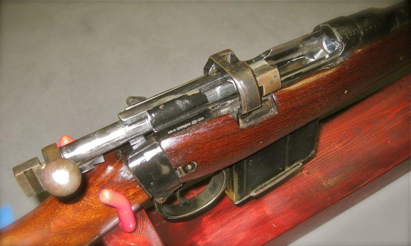

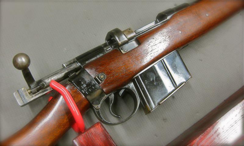

    Is it me or is that paint on the metal? What about the bridge over the bolt, looks like it is slotted for some kind of sight or scope mount?
    the wrist band is badly scratched, looks like on purpose with sandpaper for some reason, pity that.
  9. #35
    Jan 2012
    09-27-2022 @ 11:12 PM
    Province of Alberta, Canada
    67
    1,019
    05-12-2025
    01:17 AM
    BahamaLure: Yes, that's black paint. On my 2A1, which appears quite original and lightly used, there are already big ugly flakes breaking away to expose bare metal. The "bridge" is the charger bridge which accepts stripper clips for quick loading. Yours pretty much resembles the original ones which first appeared on the No. I mkIII. I'll try to upload a couple of side shots of my 2A1 later today so you can see what a non-sporterized one looks like.

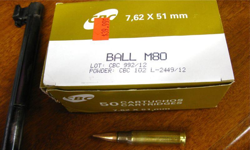

    Took the Ishapore out yesterday just because I could, went much better than the first time too! Shot the remainder of the steel case rounds at 25 yds, made a good 2" group with some key-holing so that was encouraging. We dug around the range stores and found some better ammunition I bought this box, plus they had some match rounds that were priced way higher and not what I need at this point. What do the codes on this box tell me?
    These rounds cycled better out of the magazine, but still not perfect, the left side does not work as well as the right for some reason, tinkering still to do?
