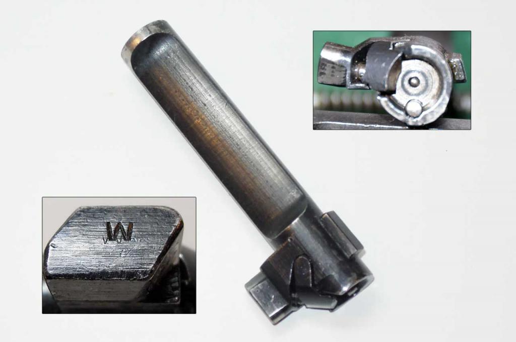

    If you look at your first pic of your hand gard, I believe there is a stamped W about 1" to the right of the stepped knotch along the inner edge.

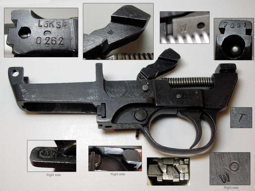

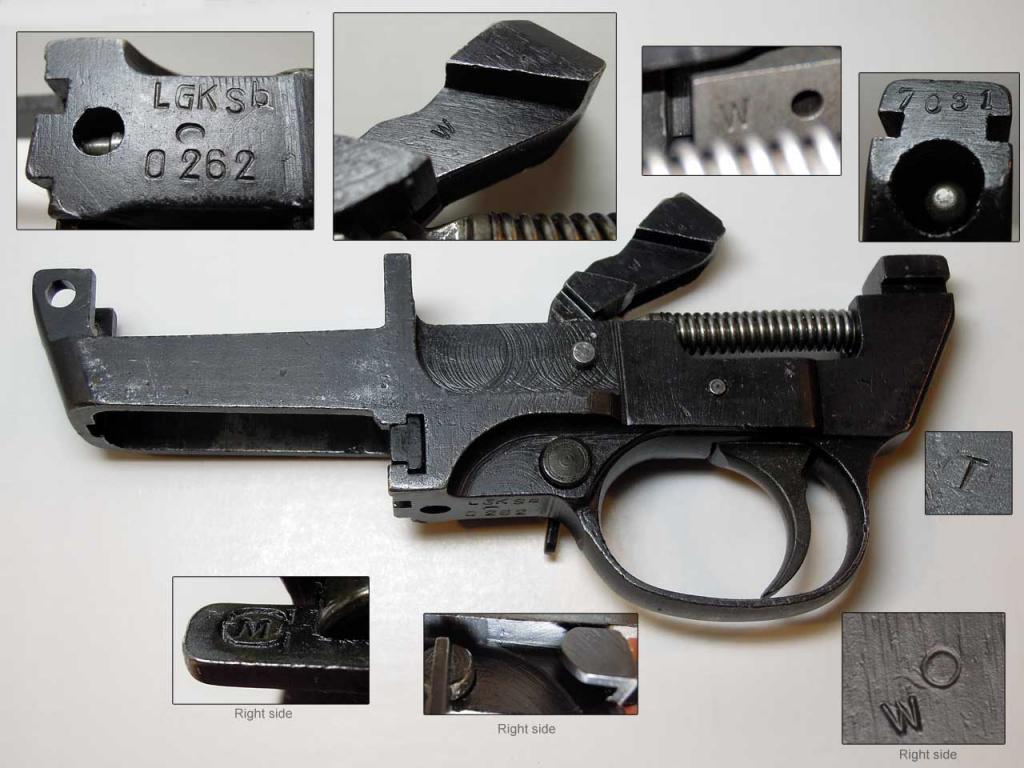

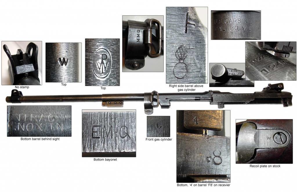

    Had some time to kill today and a macro lens camera.
    What does the 'F', 'F8' and '4' markings mean?
    It looks like an 'I' stamp and 'O' stamp, what do these mean?
    Looks like a light 'W' stamp under the more pronounced 'W'
    The W stamp is over a 'O' stamp, any idea why? What does the 'U' mean?

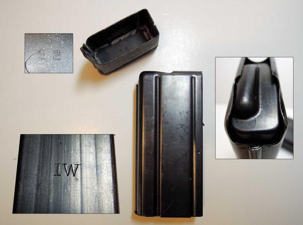

    Pick this magazine up on eBay, does this look real? Is it the right vintage for the rifle?

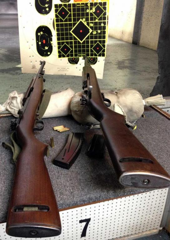

    50 yards with Aguila Ammunition. Winchester on the right, I took it to a gun smith to check out before shooting and ended up buying the NPM by Underwood carbine on the left.
