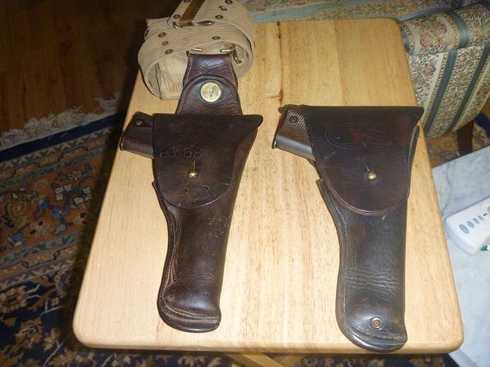

    There are a lot of theories out there on leather restoration. I consider restoration as a impossible thing. In my view, we are actually talking about preservation rather than restoration. Whatever shape your old slings, pouches and holsters are in should be preserved from further deterioration. That said, a leather preservative is the ticket and the best of the best is Propolis. So what is this stuff? It is tree resins use by honeybees to weatherproof and disinfect their hives. This product of nature resists mildew, mold and bacteria that are bad news for bacteria. Obenauf's makes a product that is called Heavy Duty LP and is available from Cabelas....a bit spendy but worth every cent. Here are my two 1911 holsters one a WWI and one a WWII that have been treated for many years now with Propolis. You be the judge. Regards, Rick.

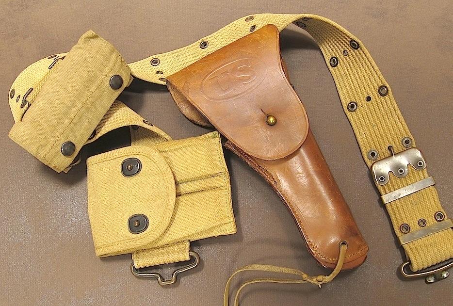

    This holster has been treated every six months or so with Pecards for about ten years. So far I like the results. Doesn't darken the leather, and apparently works. Holster is a G&K 1918.

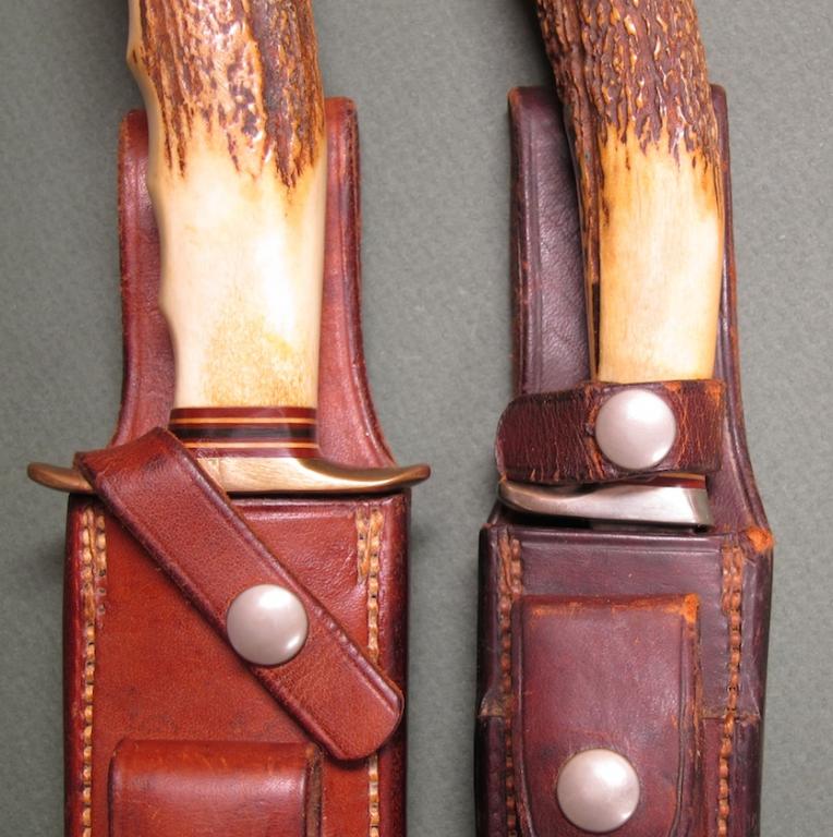

    I have seen first hand what Neatsfoot oil does to leather, and it is not good. The two Randalls shows date to the mid 1960's. The one on the right was a gift to my father who thought Neatsfoot Oil was good for everything. Today the leather is coming apart and has turned soft. The knife on the left is actually a few years older, and has had Pecards used as a preservative.

    Yes, we've discussed this before here. The one on the right was used and carried, the other has obviously not been - it has no wear whatsoever other than the obvious flex marks at the top of the stone pouch and around the snap. Properly applied pure neatsfoot oil will have no negative affect whatsoever. However, I am looking with great interest at Propolis....
