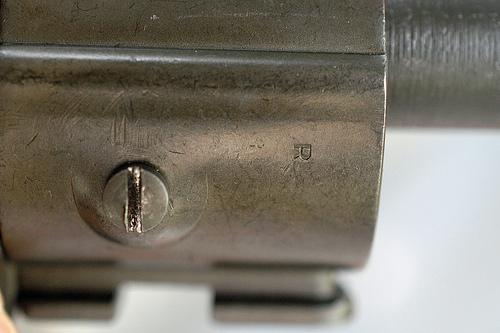

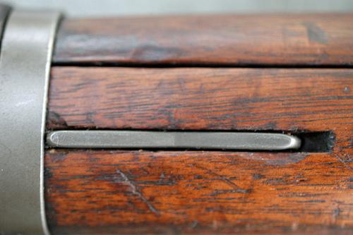

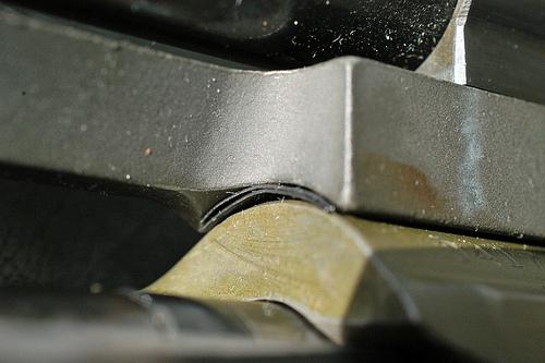

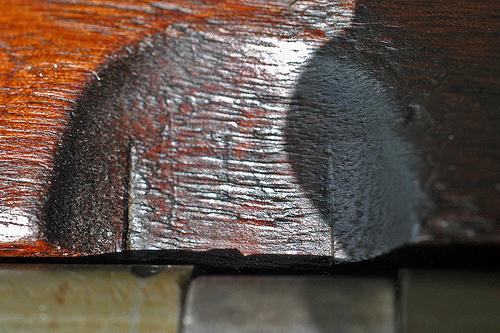

    Yes Jim, "Redfield" is marked on right rear of mount. I took some better pics for you to look at.
    Marks are faint in some areas but legible.
    Whoever cleaned the stock forgot about this cutoff area! The capital "K" with serifs is barely legible under the crud.
    I found the shims and also can peep under the mount and yes, the mounting screws are both "staked".
    I hope this new info helps all of you real detectives, I'm just happy to possess the rifle.

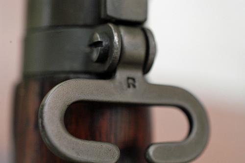

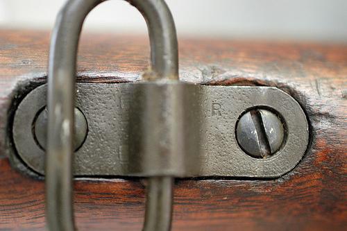

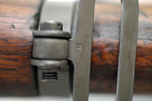

    Here are the bands and such. All marked "R" if marked. The bolt is blued and everything I found marked so far (I haven't taken it down yet) is also marked "R".
    retaining spring
    nosecap
    buttstock swivel
    lower sling swivel
    stacking swivel
    Whew! I haven't worked this hard to get photos of inaccessible parts since my last colonoscopy!

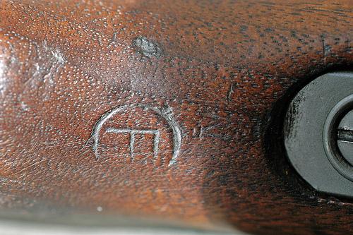

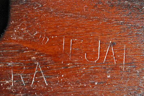

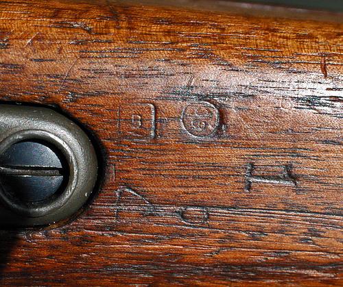

    I have one question concerning the FJA marking on the stock. The one without the rectangular surround was used before that with the surround?

    Quote Originally Posted by gioca View Post
    The information I have been able to accumulate appears to suggest that the unboxed "FJA" predominates the earliest rifles. Thereafter through the end of production both styles are used more or less at random.

    Thank you very much for the info, Jim.
    The question you had raised to larryhoosier about the "boxed" or "unboxed" FJA marking had worried me a bit since I have one 03-A4 of the first block (in the range of 3,411,xxx) with the "unboxed" FJA marking.
