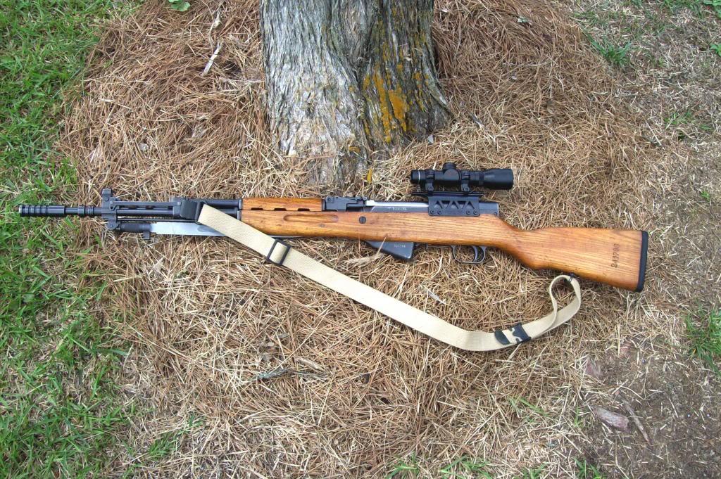

    I put the Choate drill and tap mount on my Yugoicon several years ago and it's worked out fine.
    One of the targets I shot after doing a quick zero,I used Golden Tiger,Brown Bear,PMC,Fiocchi,MFS and my cast reloads on several targets and got pretty much the same result each time.

    Quote Originally Posted by SKS50 View Post
    https://www.milsurps.com/images/impo...3d45cd73-1.jpg
    https://www.milsurps.com/images/impo...f56ea325-1.jpg
    interesting. What scope is that?
