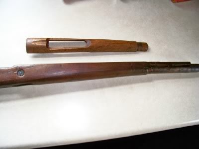

    This is a Mauser stock that came from Sarco. It looked like a telephone pole. I started with denatured alcohol, then went to the go-jo but I like the gritty type. I use oooo steel wool very lightly and a dish cleaning type brush, think big tooth brush. I like to steam out the dings very light sand paper to get rid of the fuzzies then rub in the BLOicon....Frank
