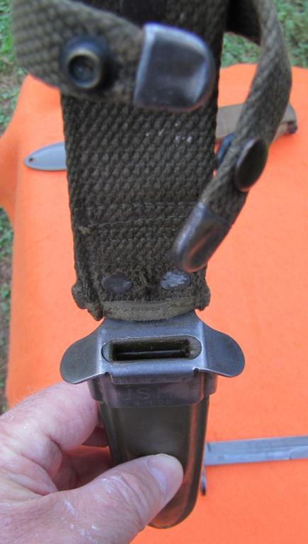

    An excellent U.S. knife reference are the Cole books. Three is probably the most popular. The Cole books are hard to find and costly. After Mr. Cole died, Michael Silvey combine the Cole books into one. In that one some information from the others was omitted. It is also costly.
    I know of three types of M-8 scabbards. Pulled them out for a few pictures.
    Top.........Short frog without the hanger.
    Middle.....Short frog with the hanger.
    Bottom....Long frog with the hanger.
