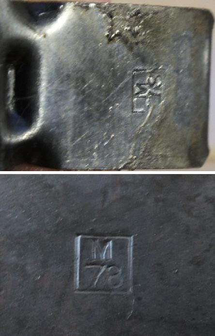

    Pics on behalf of JIMBO187

    I'd pressume the E is going to be another ID mark for Elkington,the same style of outer box containing the marking shown on the bottom plate is also used on Elkington M 78 marked magazine internal parts.
    Platform guide and bottom plate retainer below.
    ATB Kevin

    The BRNO/CZ contract stated words to the effect that the component parts, even those out sourced, such as BSA initially, had to mark their components with the manufacturers identifying mark or another mark which was identifiable to them. That's why you see the little logo on even the smallest components such as the ejection opening cover catch and the extractor stay. Daft or what!
