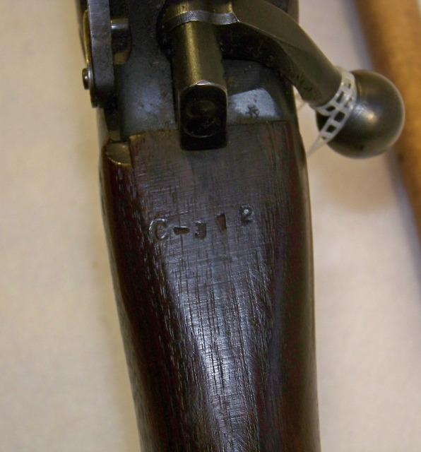

    Identifying Scope Serial Number
    Mates, I'm quite illiterate when it comes to the intricacies of Sniper Scopes and how they got mated to Long Branch snipers.
    It was my expectation when examining my 1944 Long Branch Sniper that I'd see a serial number on the wrist resembling "XXX-C," signifying a REL scope. Instead the serial number is "16539" as this photo indicates:
    Does this indicate a Britishicon scope? (i.e. Watson, HBM, Kershaw, or something else?)
    If it's a British scope, how did it get on a Long Branch?
    FWIW, on the Butt Stub that inserts into the Receiver Socket (3/4" above the scope serial number) is the serial number "39515"
    Thanks for your help.
    Robert

    Looks to me like 4x numbers followed by C that have been overstamped 16(8)539 OR 3x numbers followed by C that have been overstamped with an additional figure 1 inserted to start.

    Quote Originally Posted by Seaspriter View Post
    ...snip...If it's a Britishicon scope, how did it get on a Long Branch?
    ...snip...
    typical LB "T"
    This is the markings pattern which would be correct for your serial number.
    Long Branch sniper rifles did not have a "secret" serial number stamped onto the butt stock under the butt socket lip.
    That is an indication that your butt stock was originally fitted to British No4T serial # 39515 as they stamped the rifle serial number protected inside the butt socket and the scope serial in the open.
    I suspect it was intended as a means of keeping the scopes matched with the rifles, as British scope brackets were originally not serial numbered to match the rifle.
