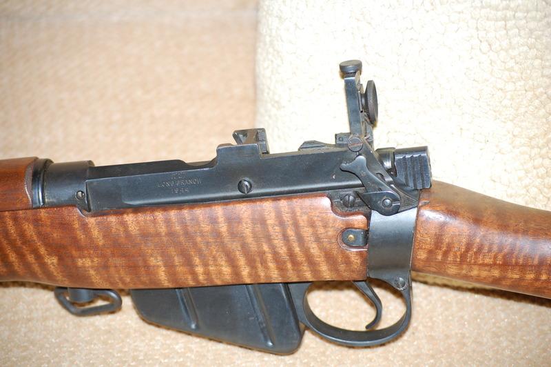

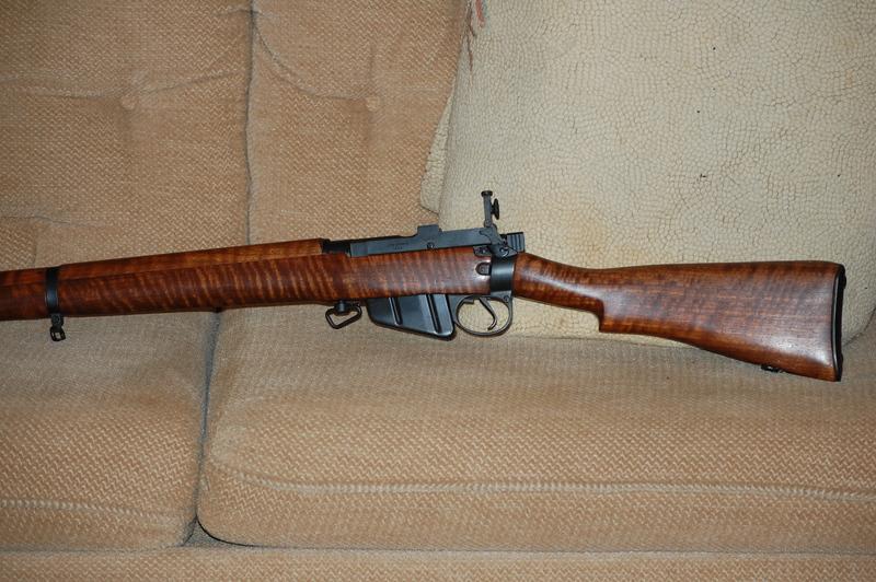

    The '44 date is a serial number scrubbed original receiver with CAL phosphate. The '46 is also a serial number scrubbed receiver that I dressed up and refinished with phosphate. Both rifles were built by myself using all original parts scrounged over the course of several years.

    The serial area of the 46 is very nice, and almost discernible from an original. The one give-away is that the little LB is missing which would normally be above the serial number area. Even the un-serialised receivers still had that manufacturer mark.
    When I give the lower prices for the scrubbed receivers, it is due to the lack of quality controls and the use of any Enfield part to complete the rifle. Very few of the garage workshops have the proper tools to tighten the barrel to the right spot or the knowledge to properly bed the wood, adjust the trigger pull, or even headspace for that matter. Pretty sure that doesn't apply to your work Brian, and as such I would expect one of yours to sell for more in the ballpark of a factory rifle.

    I wanted to illustrate your comments about the scrubbed receivers in post #9. I sourced one of the bodies in Canadaicon many years ago and then found another in Illinois later. I scrounged parts from a couple of LB No.4's I imported that were converted many years ago by parties unknown. I even visited Marstar in 2001, (what a feat!), and bought rear sight assemblies and Inglis pistol parts to complete projects I had on the bench at the time. I also imported a few complete C No.7's that were put together in Ontario by unknown builders. I always had to tune them up and especially install the rears sights properly as they were never right it seemed at the time. They were all good to go afterwards and targeted before sale. I never tried to market them as other than post service builds. I sold them for $800 or so over ten years ago. I also have a minty original dated '45 like the one posted by CODFan. I love those .22s!
    ---------- Post added at 10:02 PM ---------- Previous post was at 09:55 PM ----------
    I just looked at my '45 date rifle and it hasn't got a LB stamp on the left of the butt socket. It's sn. 0L5980.

    I missed this one by a few days 2 years ago.fantastic stock.
