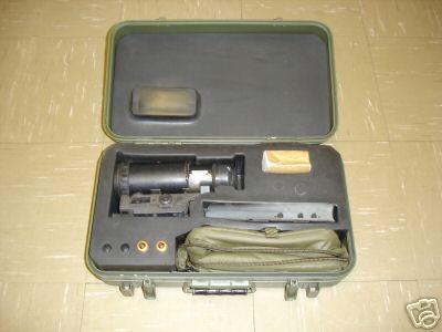

    5855-99-966-1109
    ADAPTOR, image intensified weaponsight, L4A1
    Someone has modified the modified SUIT sight mount to put it back to being a SUIT sight mount. If that makes sense.
    Here's what the mount use to look like. It was used with the L5A1 Night vision sight. If anyone has a spare I'm looking for one.
    5855-99-966-1109 ADAPTOR, image intensified weaponsight, L4A1
    This was on eBay a long time ago
    This came out of a book and is credited to Pilkington PE Ltd
