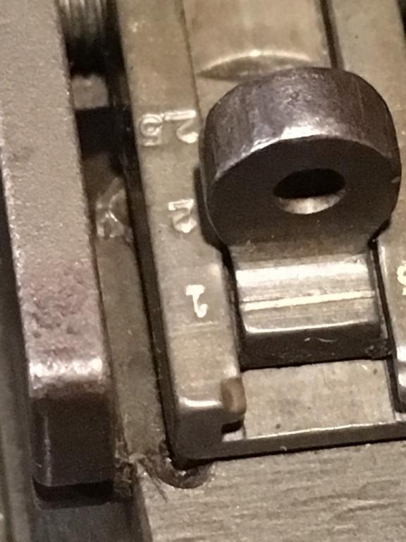

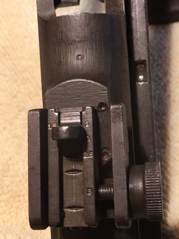

    One thing did catch my eye, the milled rear sight. I don't know if I have ever seen what I thought was an original NPM with an adj rear sight.
    Do not think anyone suggested rear sight was from factory.
    Though rear sights were replaced during rebuild they were also replaced in the field. If this is the case I would expect stake marks.
    Another thing that was common in 60s and 70s was for owners to upgrade there firearms.
    A good indication would be lack of second set of stake marks.
    Back then newer was better.

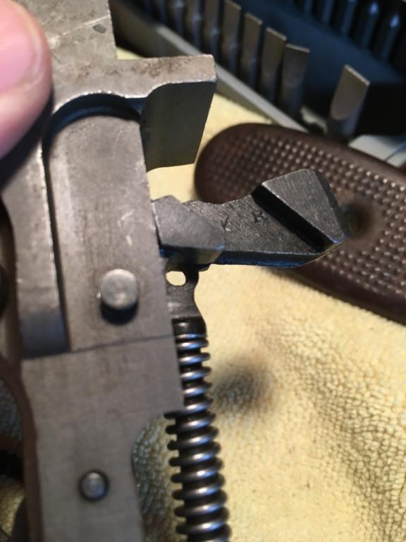

    Really hard to find hammer there. Thanks.

    There are two stake marks at the sight. I'll post a picture. That is why I'm confident the sight was changed from the original flip type sight.

    Dual stake marks at rear sight.

    Quote Originally Posted by new2brass View Post
    Check out Jack Gordon Fire Arms ad in this article
    The Good OL Days - The Carbine Collector's Club

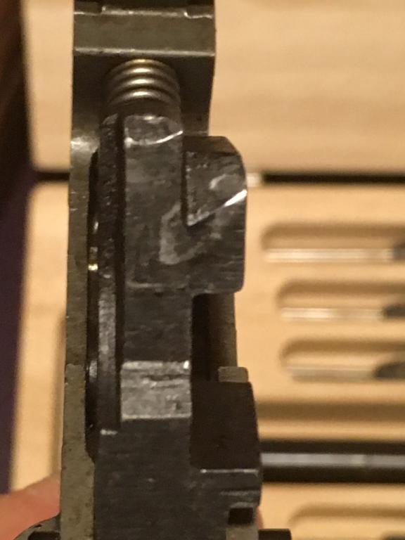

    You were right, there is a chisel mark front and rear on the "left" side of the receiver at the sight dovetail. Look closely and you will see them...
