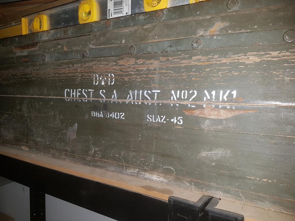

    Things not being helped though, i do not really have a dedicated work space, but I'm working on it. We just built a rather large garden shed for alll the gardening gear and storage for our 4x4 and camping gear, that will free up a massive amount of sapce. I may even be able to store a vehicle in my garage!
    During moving a bunch of junk though, i did find something i forgot i had.
    "old army wooden toolbox $40" the sign said when i bought it. Forty Bucks! I'll have that!
    **EDIT**
    I just finished my dedicated reloading bench tonight, its small but at least functional
