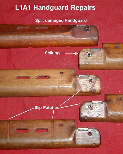

    The main problem with wood L1A1 handguards was splitting longitudinally from the front cupped and threaded insert forwards for an inch or so. We had to patch those PDQ otherwise the screw and threaded insert would just rotate and nothing would get it out. for some years during my time in Malaya, a longitudinal split along the top rear along the rear of the gar cylinder could be repaired by roughing up the wood and overlaying that section with a 1" wide 2+" long 3/16" or so thick piece of wood beveled at the edges. It worked well and stood up to the rough treatment they got out in the Far East. But never saw it adopted in the UKicon. Laminated was the best things we had. I seem to recall that the quarter guard who formed up for visiting dignitaries couldn't have the laminated hand guards french polished or varnished because they were treated with some special chemicals. Probably the same stuff that they put into the single blokes tea!

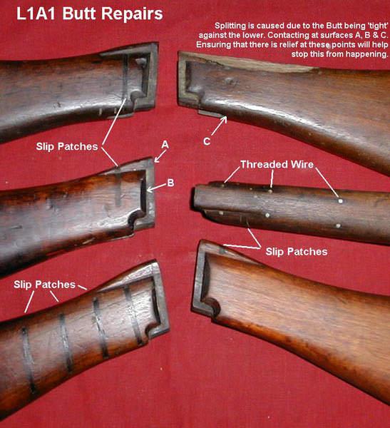

    Here's some photos showing some of the various handguard repairs
    and the same on the Butts

    Thanks for the info kev, I think I have examples of slip patch repaired butts and forends in my spares box. I will have to dig them out.

    We used to repair the front of the hand guards by completely cutting away the front at 60 degrees to half depth and wood patching at 90 degrees to the grain. That seemed OK. But once the threaded insert came loose again - as it would - it was the end of the line. That's a LOT of slip patches in a butt. But if needs must, then that's what you do.
    As apprentices we would patch butts and grips time and time again until the cows came home just for the experience but it was NEVER good enough for Paddy Reilly or Jack Hobbs the class instructors. Some examples of superb work were presented to visiting dignitaries and a brass plate tacked on. But mine work was usually just piled in the corner with the remainder of the 'also rans'
