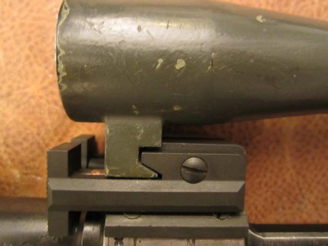

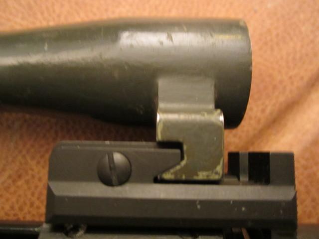

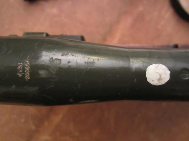

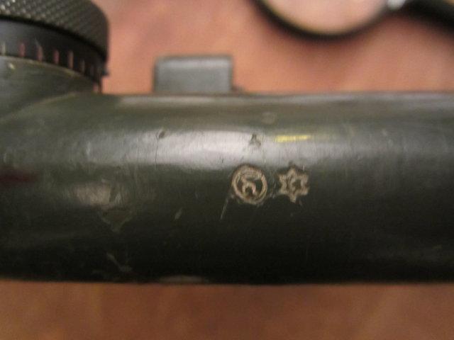

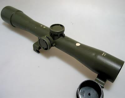

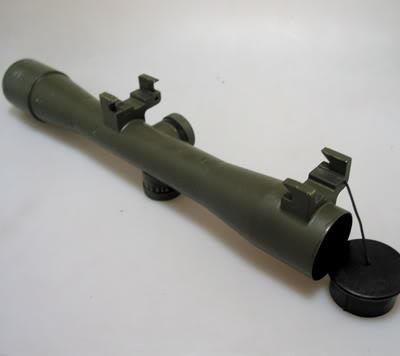

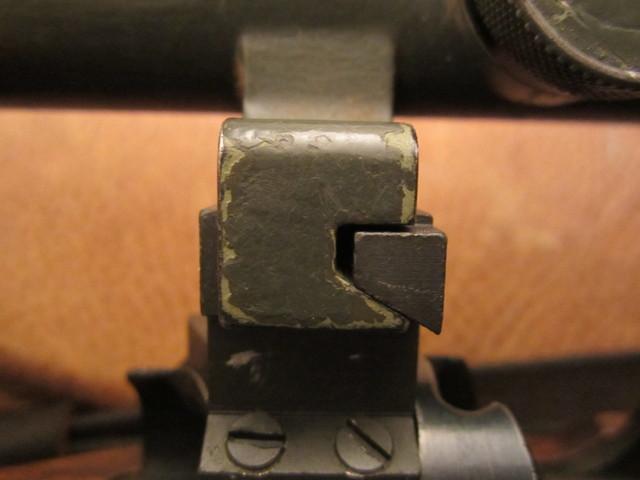

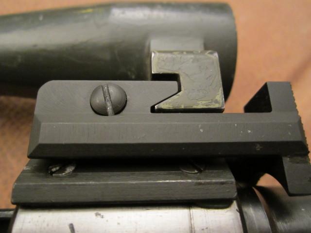

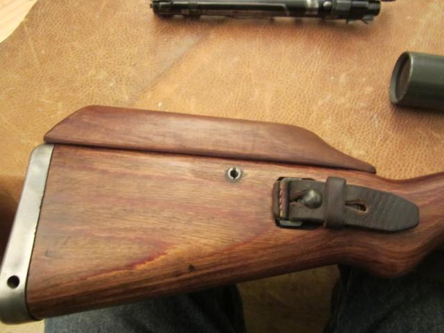

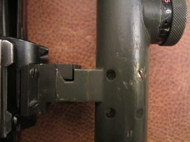

    Hello,
    can you please identify the scope which has been fit over this Israeli K98icon Sniper ?
    Thank you.
    Here are some pictures.
    Salu2 a to2
    Bizio
    Oct 2009
    Europe
    1,888
    06-08-2025
    10:54 AM
    The scope is from Wild. The IDF also had Nimrod scopes.

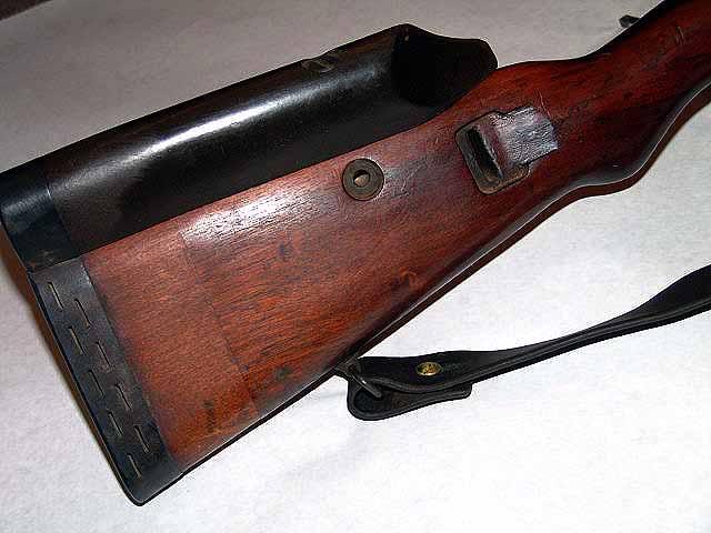

    The buttplate on this rifle looks somewhat strange. It shouldn't have the metal cupped buttplate and the cheekpiece loogs odd aswell.

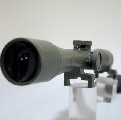

    Hello Promo,
    thank you for your answer.
    After you told me that's a Wild scope, I found this very similar
    Finally!! Israeli Sniper Scope located for my Mauser... in The C&R Sniper Rifle Forum Forum
    Salu2 a to2
    Bizio

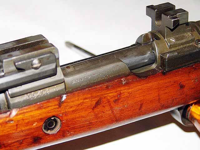

    idf scope wanted
    hello, I have a FN made rifle like that. I need to find a scope or separate mount fro the rifle.
    my rifle has the same butt plate, Kriegsmodel style. what is neat it has P14 sling mounts in the front of rifle also. any help would be gratefull,

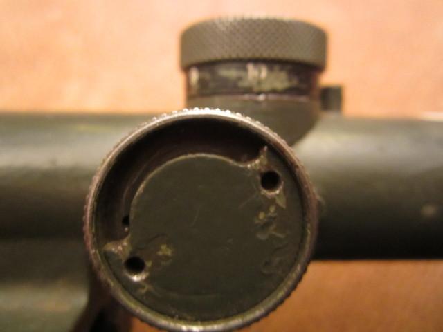

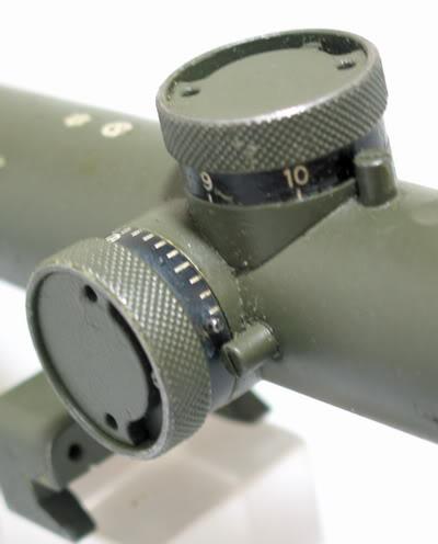

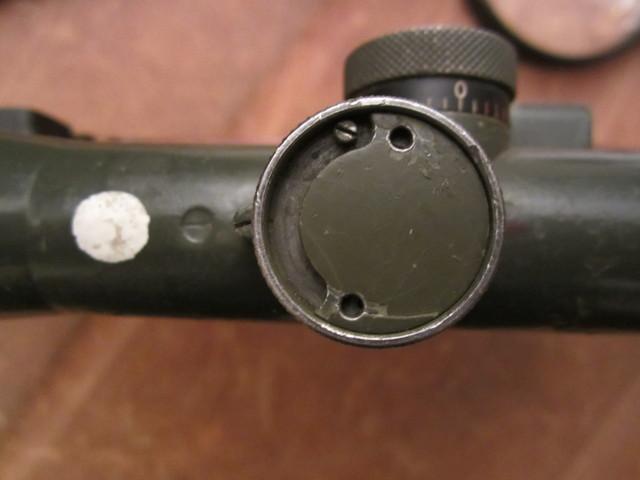

    manual
    any one know how to adjust the windage on the wild scope as have run out of windage to get zero
